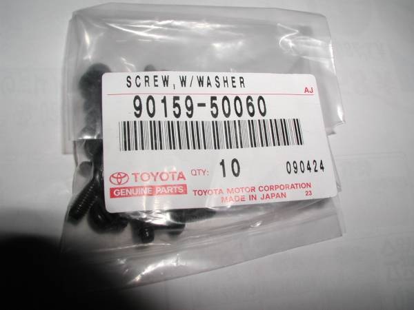

The Doctor Wrote:parrot Wrote:Which seller did you get your flares from? So hard to know which ones to get, that are an exact copy. Serious drool.... I get a bit on Yahoo. Do you know which seller it was? And did you get standard or oversize? [img name=]http://www.aeu86.org/files/fl/flare_screws_129.jpg[/img] These are apparently the actual screws used. |
