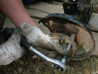

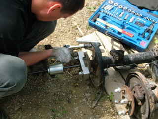

I tried to disassemble rear axle last week with special made tool. I was using a sliding hummer with custom made adapter with two wholes for wheel bolts. As you can see on this few pictures. It works. No BIG hummer needed Thumbs up!

max_ae86; I tried the thing with the slide hammer as well. It broke. My axle is insane! Sad

I used the rear end of an AX - no problems getting te axles out

I would advise to weld on some rings to attach a rope to the weight on the slide hammer. Pulling that metal cilinder really fucks up your hands in the long run. The rope also makes it easier to whip the weight faster.
I got the axles out of my axle by beating on the hubs using a large hammer and solid piece of wood to cushion the blows. Took me about 30 minutes of hammering to get one axle out..damn garage put in liquid gasket or loctite between the bearing and axle surfaces.
