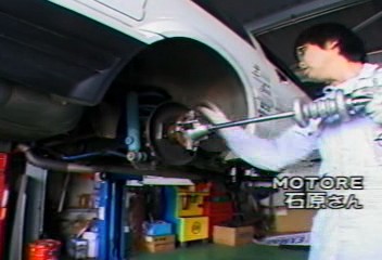

It's called a slide-hammer I think. As filh described it, a metal pipe, welded to the center of a wheel so you can mount it on the hub. You then fit a heavy cilinder around the pipe and install some sort of handle on that (or a hook to attach a rope). When that's on you need to install a stopping plate (or screw like filh said). You then beat the cilindrical weight against the stopping plate and the resulting impact works like a hammer, only one that pulls in this case.

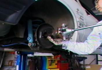

Well summarized Ivan . Didn't know the right name for that tool.
The problem with that kind of work is mostly the rust. If you do it hammering a rim , it will pull the bearing , but the power of hitting is not very symetrical . With the tool i discribe , the pulling is applied at the center of the axle . When i remove my axle , i only have to hammer 3 or 4 time and it's out , but i remove them so often for service and repairing!!

stumbled on to this pics on my hard drive Smile
Screenshots are from AE86 club, Keiichi's personal video magazine.
