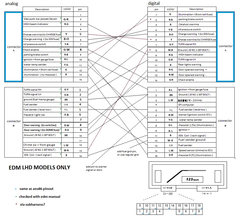

Translated a japanese diagram I found (don't ask).
Still some odd things I couldnt translate, but those are mostly unconnected pins, so no sweat.
It matched the earlier diagrams quite well, but for me this is easier to read.
The grounds and supply's might be missing a link or 2, but they should be connected up in any case.
It adds a bit more detail to what we already know (chime / speed sensor pins, the fact that the fuel sender has a separate ground pin)..

04-28-2013, 10:12 PM
Post: #108
Digital Dash
Figured out some more. One of the japanese scribbles turned out to be for the starter signal. Perhaps the dash does something on startup when this is wired up? Or maybe it just uses it to stay powered during cranking. All vids I could find are of retrofitted dashes, and we already know how much data most conversions are based on.
I also ditched the speed sensor wire since I'm not sure how it's meant to be used. Usually there is a reed switch in the dash that outputs pulses according to the cables speed, but it's usually 1 blue/white wire to ecu, and 1 brown one to ground, but this dash apparently has 2 blue/white chime related wires. I cant figure out the characters on the second wire just yet.
Anyway.. updated the old post with the new picture.
