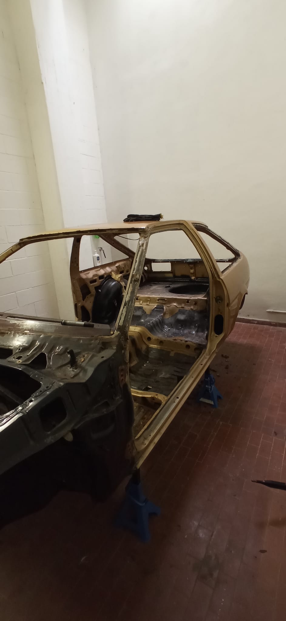

It'a AE86 Toyota Corolla Coupé GTi from Austria, 1984 model. Original color 4E1.
Thing that are missing:
- All of the Interior
- Engine
- T50 transmission
- Rear and front bumper
- All the light (front and back)
- Quarter back windows glass

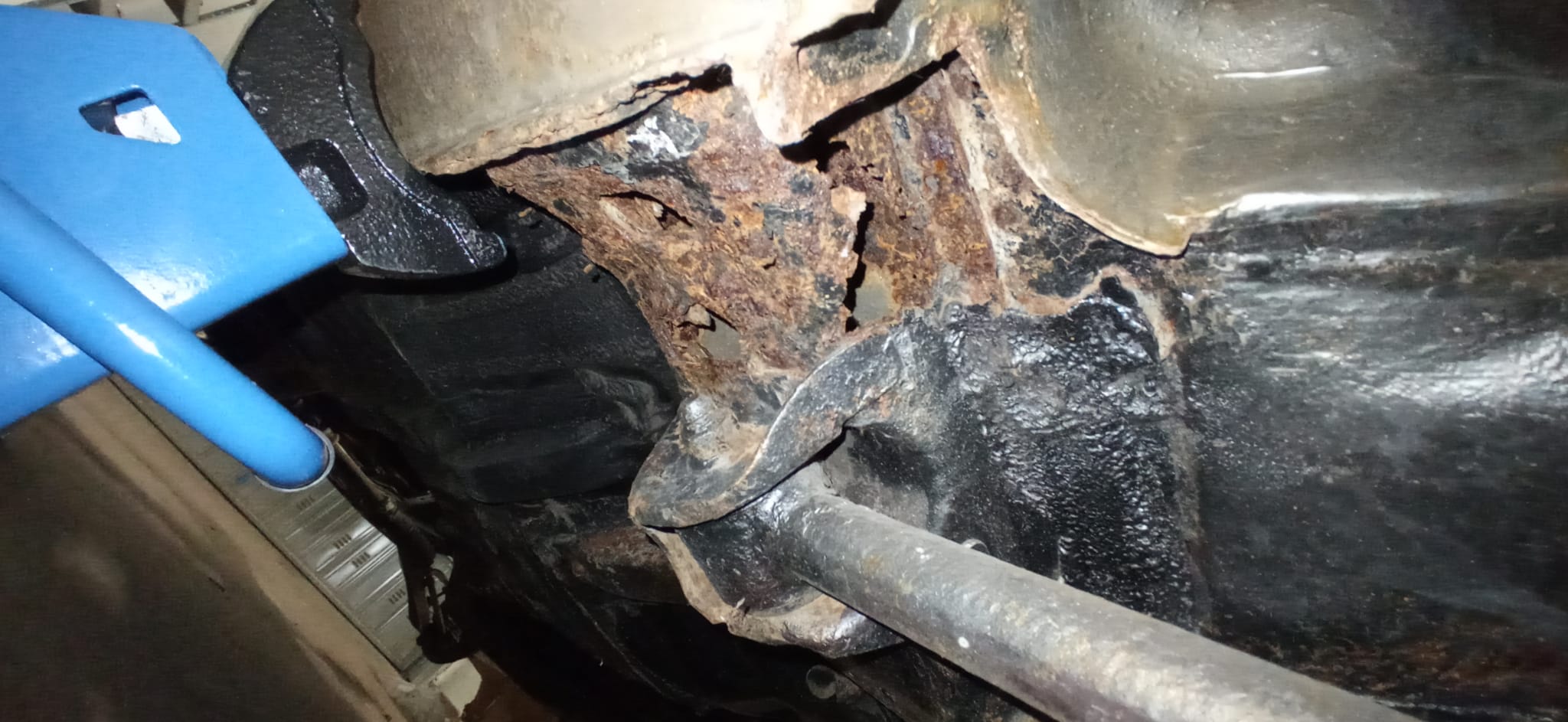

It still have the rear axle (still don't know if open dff or lsd), no cracker, and all the front wheel assembly, all the brake calipers, front and rear suspension, two side mirrors.

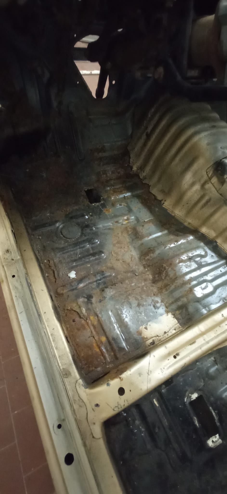

Overall the rust situation it doesn't seems terrible, at least inside the shell and in the front. There are only a couple of points in the back that concern me but nothing that cannot be repaired! Of course i think that something nasty will come out once i start to digging, but we'll see!

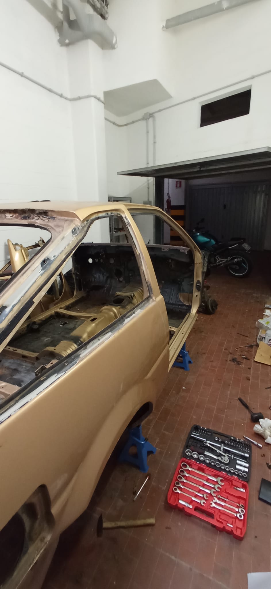

Here some photos of the actual state of the 86

Other than the two bad rust spot un the chassis, all the other points should be easy to fix (with new metal), i've never done anything like this and i'll try my best!
For now during the weekend i've stripped down and now i can properly start to hunt down all the rust spot.
I've managed to remove the windshield with the piano wire like advised in the manual, and i would say that worked great and it was fast and simple Smile
Onestly the parts that scare me the most it's the bureaucracy, here in Italy when it's something car related, it's simply a nightmare Crying
Anyway, in the next days i will finally start to see more bare metal and less rust Thumbs up!

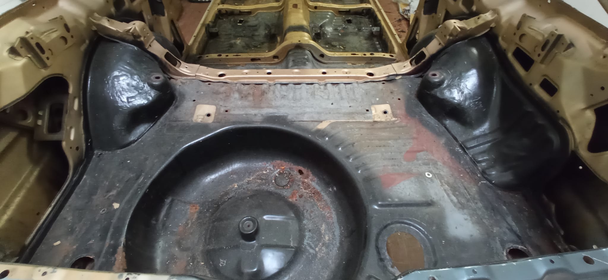

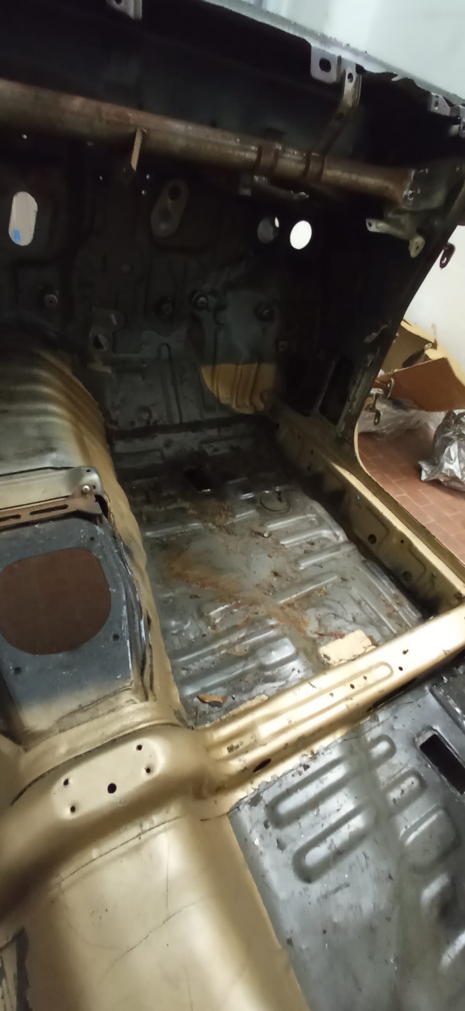

Chassis and bodywork:

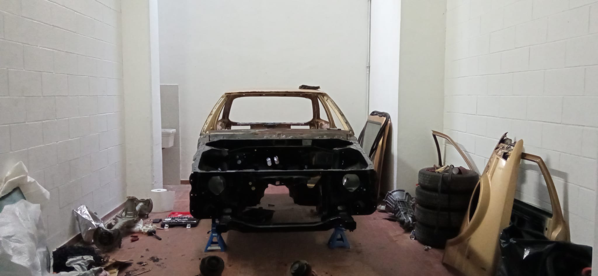

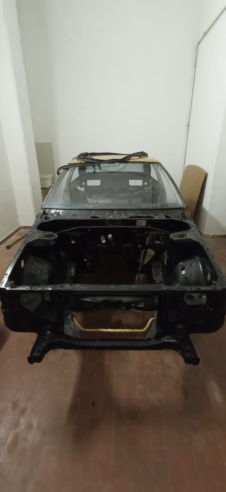

I removed all the rust, either by cutting the metal and replacing it with new pieces, or by grinding it away where it was just superficial.
All the metal patches i have done are far from perfect, but they work just fine and once the interior will go in place no one will see them Dodgy
[Image: AEU86 AE86 - Blaze's AE86]

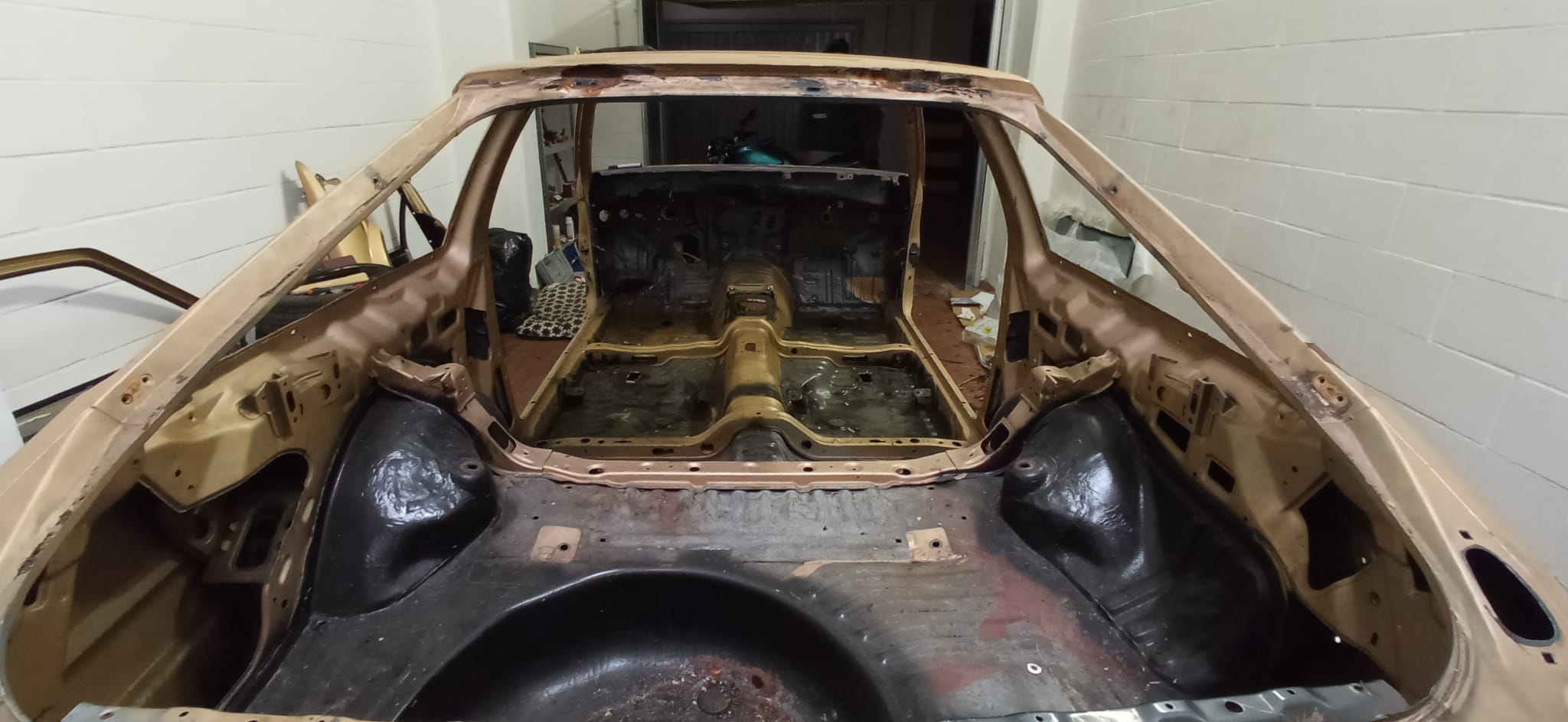

I've fabricated the two frame rail at the rear end of the car, and verified that the bumper is sitting nicely. I think it looks good!

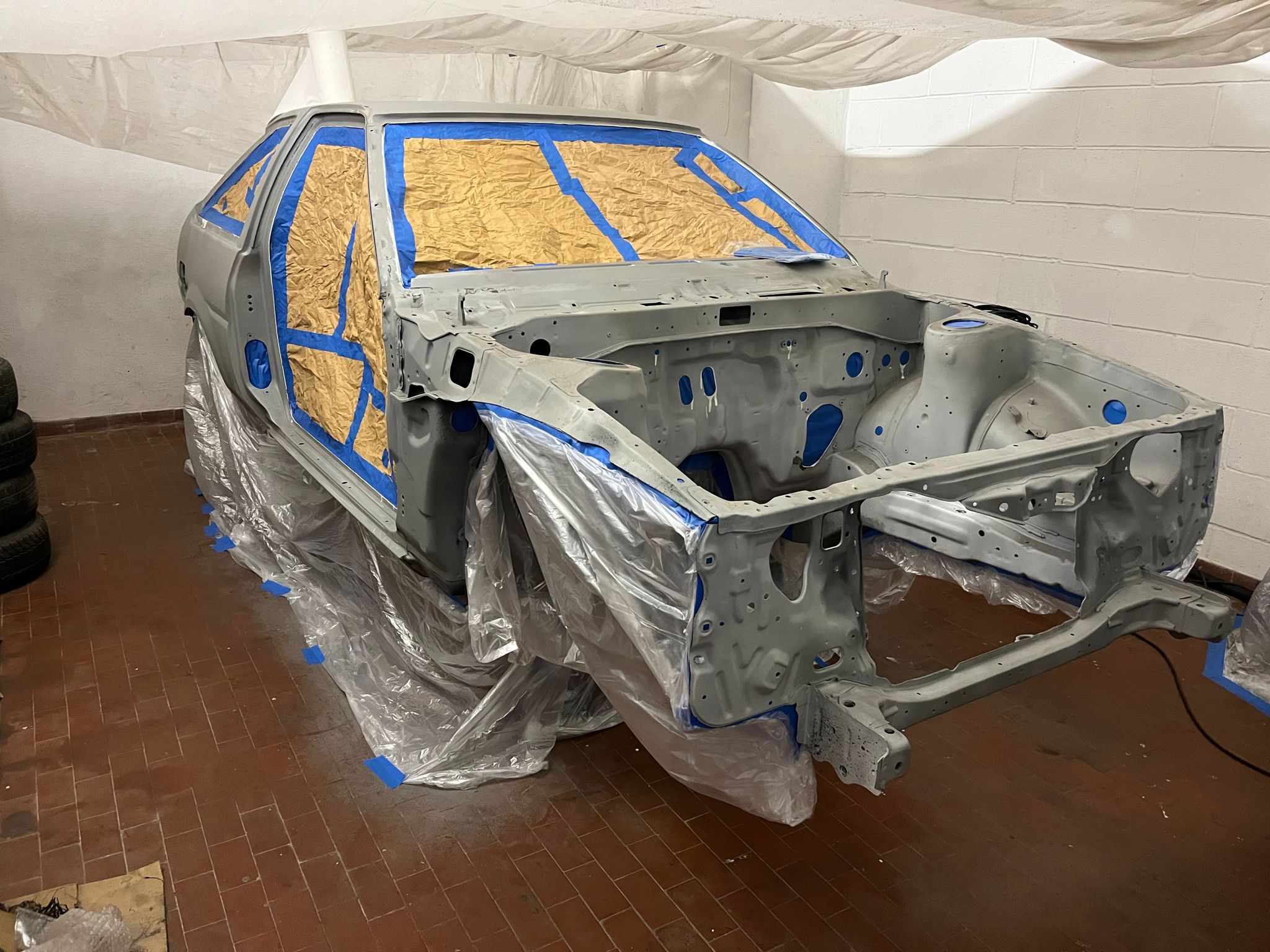

Painting:

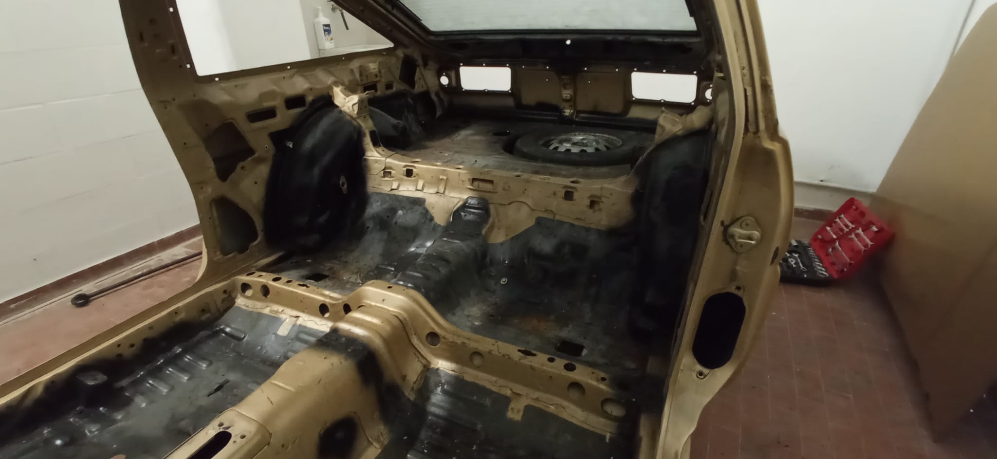

Once i was sure that the rust was gone, i've cleaned every surface and applied epoxy primer literally everywhere, underside, outside and inside. After that in the inside i've used just a metal gel paint to make it look nice and uniform.
Underside i've sprayed the 3M 8874 Rocker Shultz, really like the finish and it looks very sturdy.
I am now proceeding with filler and i think i will paint it the next weekend, with the classic two tone white and black, in the end.

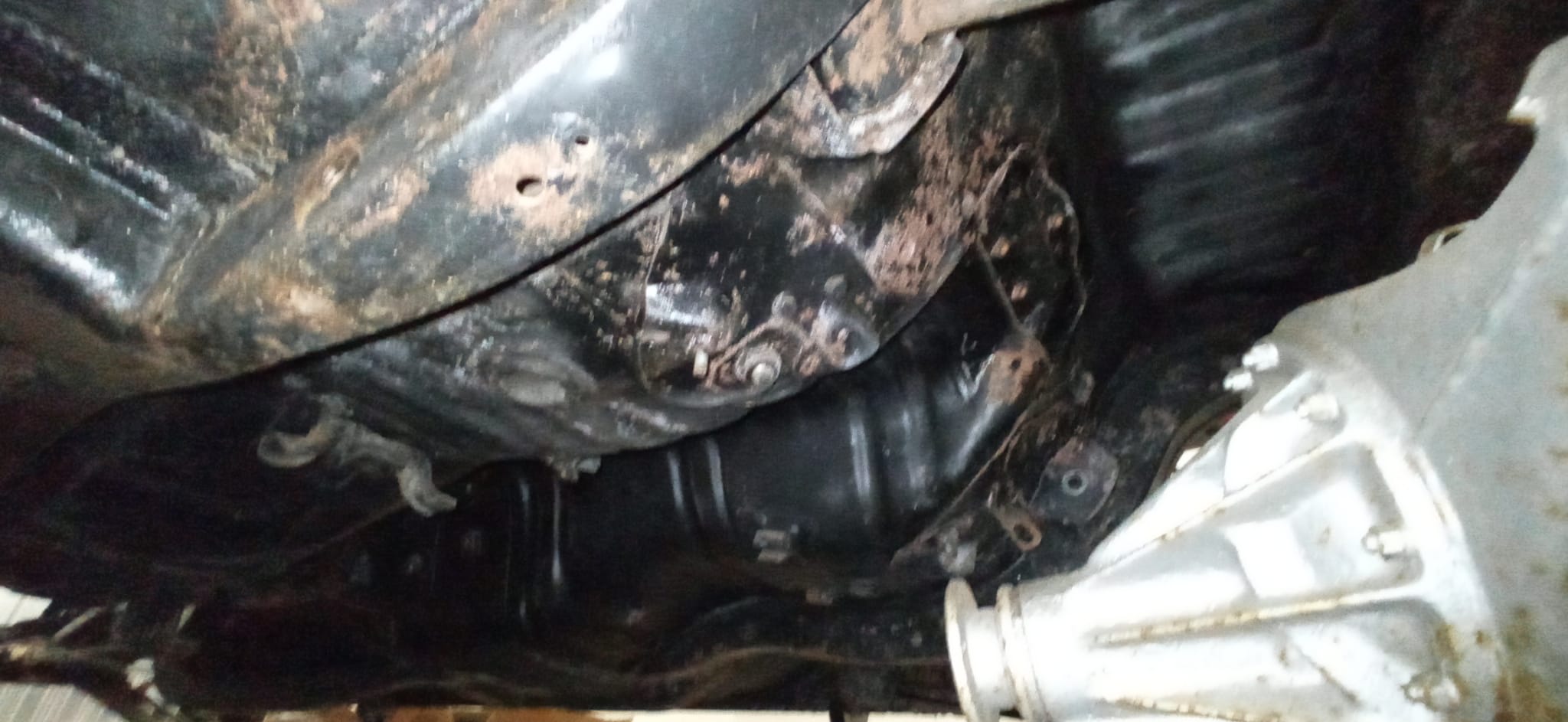

Axles:
Front and rear axle repainted and rebuild, now i just miss the brake discs, and i will be able to finally put it again on wheels, once the painting it's over
When i opened the rear axle much to my surprise i've found inside an LSD OEM diff in good shape, so i just replaced all the bearings of the diff and the halfshafts.

One last pic of the current state of the car from few days ago, just before a second hand of epoxy primer and the body filler.

Awesome work. Just one tip:
"I've fabricated the two frame rail at the rear end of the car, and verified that the bumper is sitting nicely. I think it looks good!"
Test fit your fuel tank, it gets squeezed tight against the frame rails when installed. I got lucky that I could get it in far enough because I made my new
rails too wide.
08-07-2023, 04:39 PM
Blaze's AE86
(08-07-2023 03:46 PM)Ivan141 Wrote:  Awesome work. Just one tip:
rails too wide.
Thanks for the tip! As soon as i get the fuel tank i will immediately check this. I think i've managed to keep the same size and position, but with no fuel tank with reference i can't be really sure
