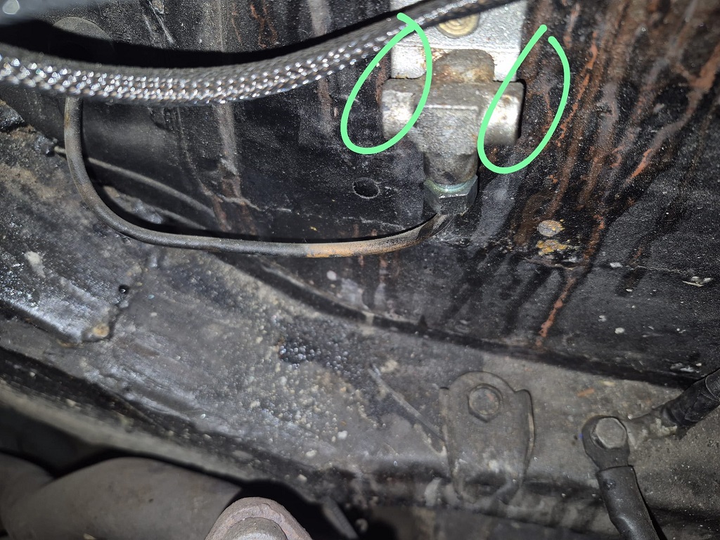

So I've started disassembling the current setup. Does anyone know the thread-pitch that's used? I want to make new braided lines Smile
[Image: AEU86 AE86 - Bigger brake master cylinder options]
These three (front, near passenger firewall, LHD)
These two (front, below the master-cilinder, LHD)
This one (rear, passenger side near the differential, LHD)
11-25-2025, 09:05 AM
I believe the correct fittings are M10x1.00.
