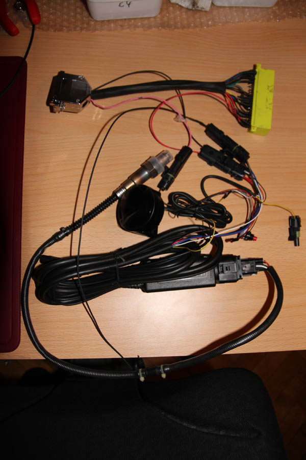

I have finished my adapter loom to connect the MSII to the stock wiring loom. Also included some plugs to connect my Innovate wideband lambda and reconfigured the two analog outputs to both being a wideband output Smile[Image: AEU86 AE86 - Bean Bandits Levin 'Globetrotter']
mid end february I'll get a new small notebook (Asus EEEPC) so tuning will start as soon as I get it... in the meanwhile I'll attach my wideband and EGT I have to gather some information of the stock ECU.

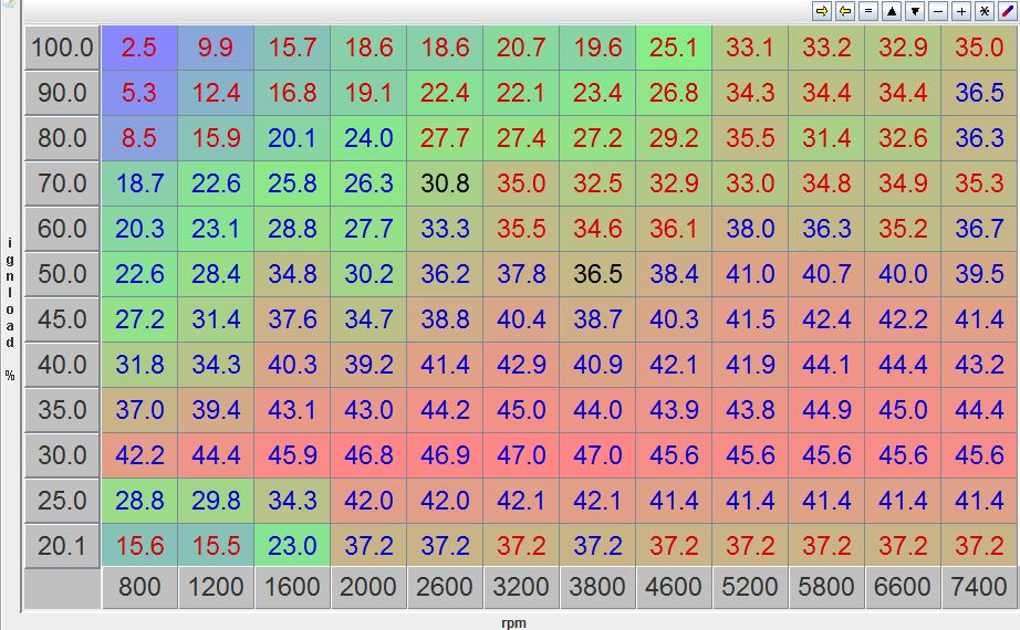

I have also mad a ignition map according to the data JRM_AW11 has pulled of the stock ECU but it's realy advanced and I'm abit scared to realy try it on the car right away.[Image: AEU86 AE86 - Bean Bandits Levin 'Globetrotter']
also attached the conversion of the original table I came up with in an openoffice (freeware) excel sheet - any input on this is welcome
