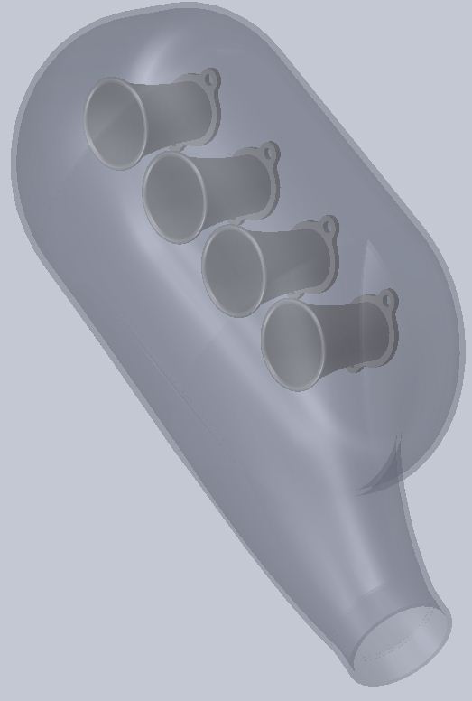

My experience: skip the calculations and just make it as big as possible. I've done hand calcs, ran simulations on CFD programs coupled to engine simulating software etc. The influence of runner length is pretty accurate, but plenum volume just gets lost in the noise. And that was on a pretty straightforward single cylinder engine..never mind 4 cyls.
The installed effect really needs to be measured. We made a nifty little variable volume plenum and determined the volume where an increase in volume did not increase VE. A far bigger influence was the design of the plenum and ancillaries themselves! Smoothnes, radius etc etc. A wheel to steer the front of the car A pedal to steer the rear |

NoHachi Wrote:A far bigger influence was the design of the plenum and ancillaries themselves! Smoothnes, radius etc etc. I try to go as big as sensible - regarding design that's why I try to draw something up... I tend to go with ~90mm stacks - if I mount them complete inside the plenum that will leave quite a big volume underneath them which I'm not certain on the effect it'll have. AE86 ex-daily |

small update: it's far from how I want it to be as I only start to get my head around the CAD programm - don't have the one I was used to (unigraphics) so need some more practice...

finaly finished the airbox build on PC - real thing will have to wait a bit...[img name=]http://www.aeu86.org/files/ai/airbox_981.jpg[/img]

my final product will be similar to the Mikaru one but bigger (my car is LHD so more space available) - also both boxes seem to use very small stacks... I'll be fitting 90mm stack inside my box so it already needs to be considerably bigger. I'll be designing the final solution on the car to max out the usable space - the model is just a guideline and I had fun working with a CAD programm again. It'll be two piece aswell, one bolting to the ITBs along with the stacks and the other as cover with the intake for the filter - this way I'll be able to test the difference between open stacks and the closed box

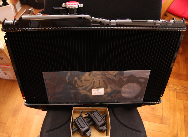

finaly some more bits have arrived...[img name=]http://www.aeu86.org/files/im/img_3848_499.jpg[/img] and pic of my fitted wideband gauge [img name=]http://www.aeu86.org/files/im/img_3846_887.jpg[/img] next week I'll be fitting the rad and some more stuff if I progress quickly enough. AE86 ex-daily |
