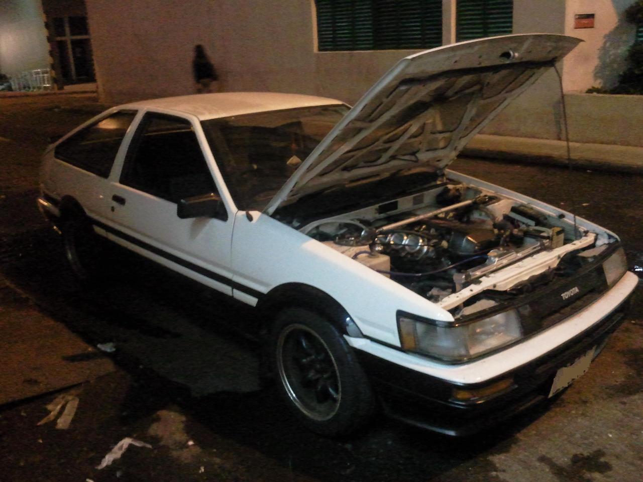

Some of you might know I am doing the said swap, anyway, cut the crap and straight to the point, just want to share the project. Nothing really fancy as lots of people from this forum had completed this conversation!!!
Would not post all the detail, my work is crap compare to other people's master piece here. But pic can be posted on request if you guys are interested in my poor detail. The car is running again, do a 15min. test drive last night, no speedo, no rev. signal, neither water temp signal to the dashboard. So don't know what am I using on the engine. Dyno result is 200 whp, with 19.9kgm, but it don't really mean too much to me IMO. Still got a lot to do b4 it can run smooth.....but it drives now! So, here is my first impression, your comments are welcome!!! - car feel a lot heavier, especially when you turn your steering. (may be I didn't touch it for long time, my arms are weak now!) - Same as above - corning not so responsive as b4. Now the wheel alignment is shit - need to do it up later. - Not really crazy power from the 3S - may be I didn't rev it up enough. - Low end torque feel richer then 4A (I am talking bullshit on this point)!! But the conclusion is - I AM HAPPY with it!!! |

A few pic attached!

Trial fitted completed.
Engine up and down more then 10 times until it get to the right position! [img name=]http://www.aeu86.org/download/ae86/id/14293[/img] |
