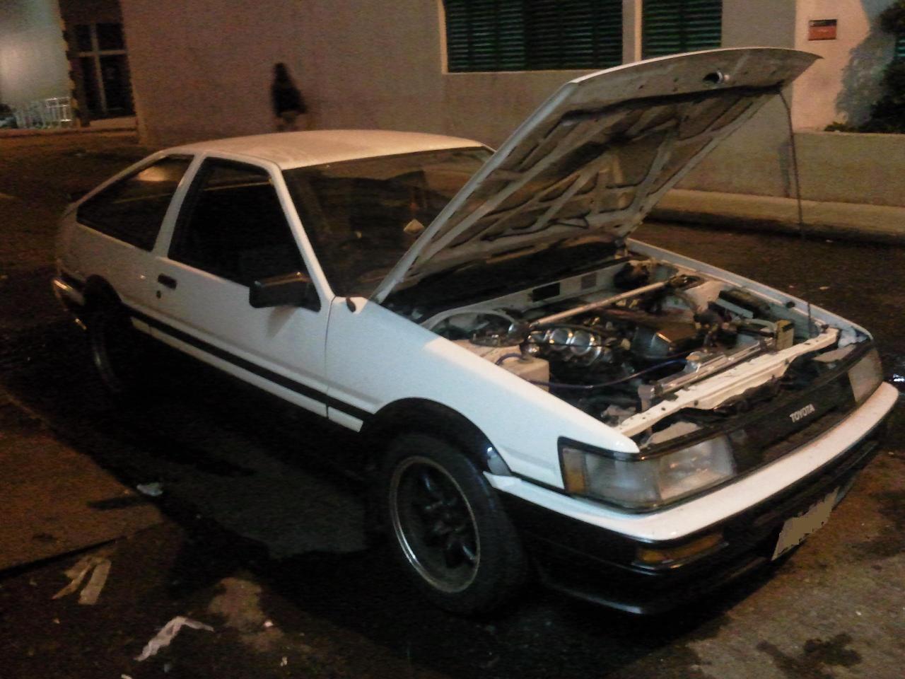

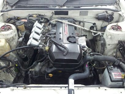

A few pic attached!

Trial fitted completed.
Engine up and down more then 10 times until it get to the right position!
