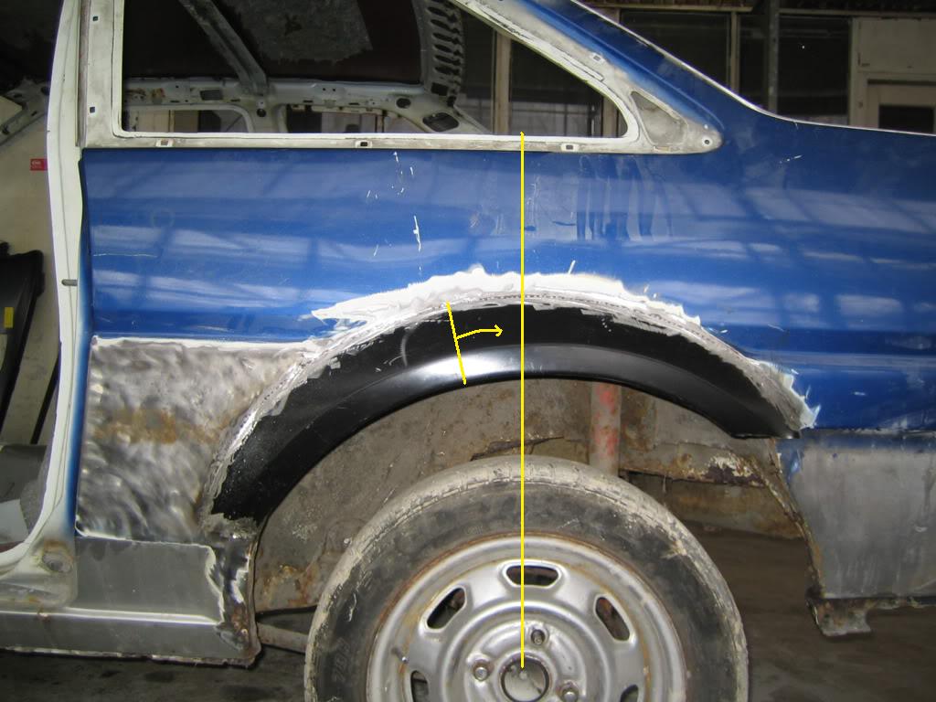

I think that fender flare should be turned a little bit rear...
You should measure where is a centerpoint on the flare and a rear arch, then put it on right place. "Tämmösellä modernilla autolla, niin mun mielestä, ei tämmöstä kisaa voi ajaa. Tää käy kunnon päälle eikä riitä aivot tähän touhuun!" ""With a modern car like this, in my opinion, a competition like this can't be driven. It's too physical and your brains can't cope with this stuff" -Henri Toivonen 2.5.1986- http://www.youtube.com/watch?v=OwgB4Xs4LVQ |

Yes, good point, this one is coming off, and I will be there when we fix the new one.
