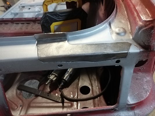

And finally (?) a niggling little whole at the bootlid catch area...
[Image: AEU86 AE86 - AE86 booter]
And of course, more niggly little bits...
[Image: AEU86 AE86 - AE86 booter][Image: AEU86 AE86 - AE86 booter][Image: AEU86 AE86 - AE86 booter]

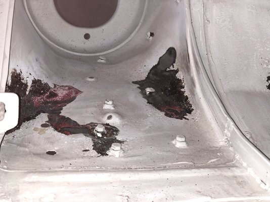

At this stage I thought I was ready to `key`the epoxy primer on the underside and finish with a final coat over the entire underside. However, things took a serious turn for the worst....
I spotted this:
Which when I investigated further with a razorblade turned into this:
So I then tackled it with a needle-gun to reveal more

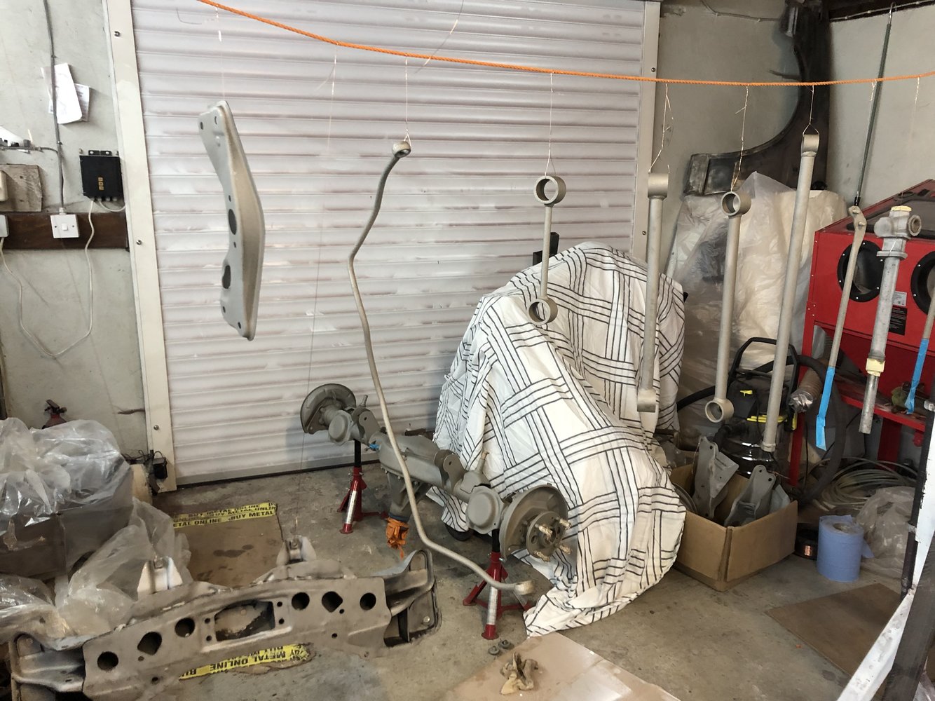

So while contemplating what to do, I found a local blasting firm and got the axle, front subframe and various suspension rods and links blasted
All elevated and ready for spraying. I used Rustbusters epoxy mastic in black; EM121
Not perfect, but it won't be seen that easily as it all goes underneath the car. I found that even though I had thinned and preheated the paint, it started to go off in the gun after a period of time, so it needed to be further thinned..

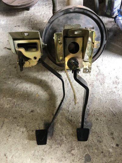

Got a few bits zinc plated...including the pedal boxes
