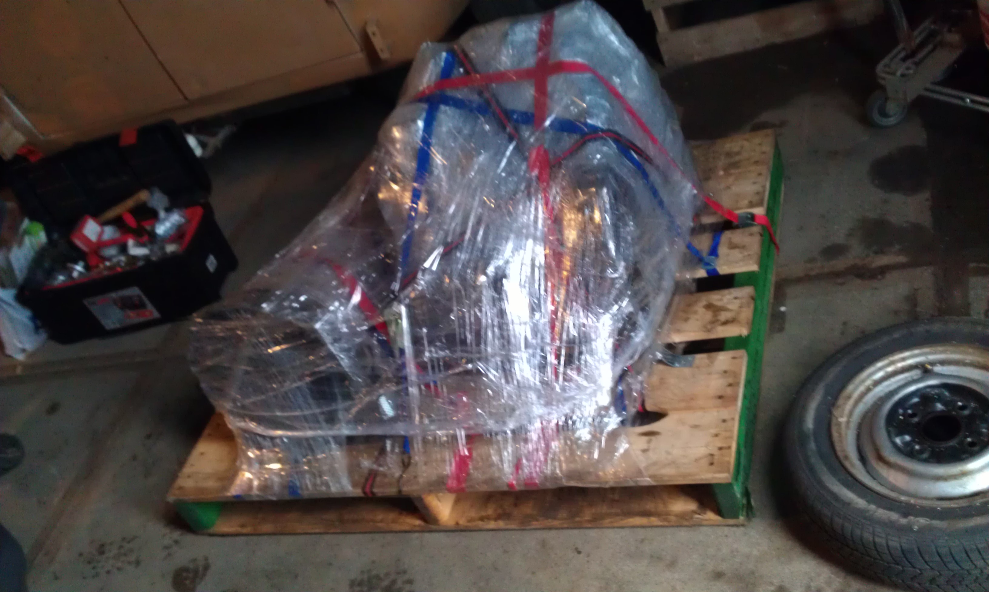

Here's a bump hoping that this thing will regain new life:
New heart for the car making its way to Hungary:
[img name=]http://www.aeu86.org/files/f2/f20cpallet_970.jpg[/img]

Great to see that the project is reborn!
What engine is that?
