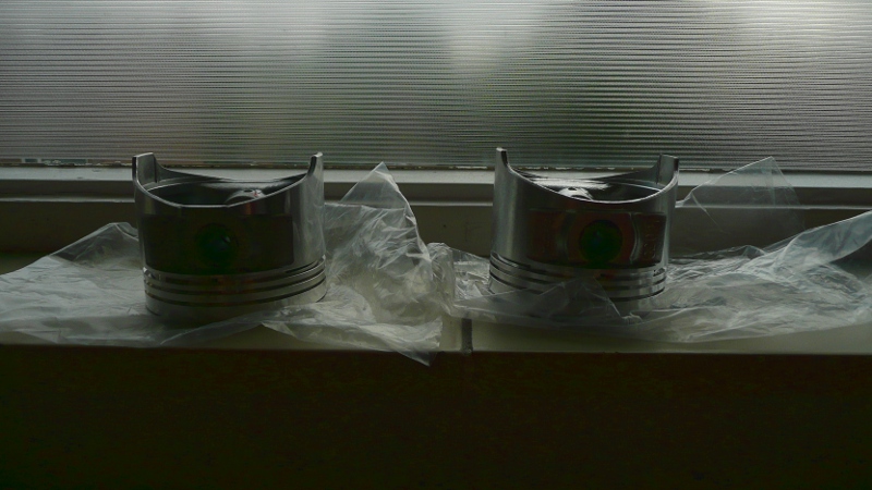

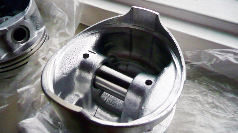

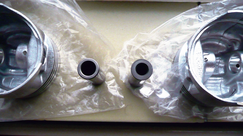

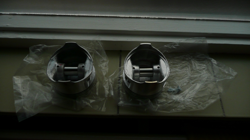

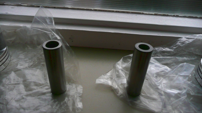

as promised, some side by side pics.
Excuse the quality, light conditions in the evening arent great. 16020 9.4:1 on the left. 16030 10.1:1 on the right. FABRICA MI DIEM, PVNC! |
