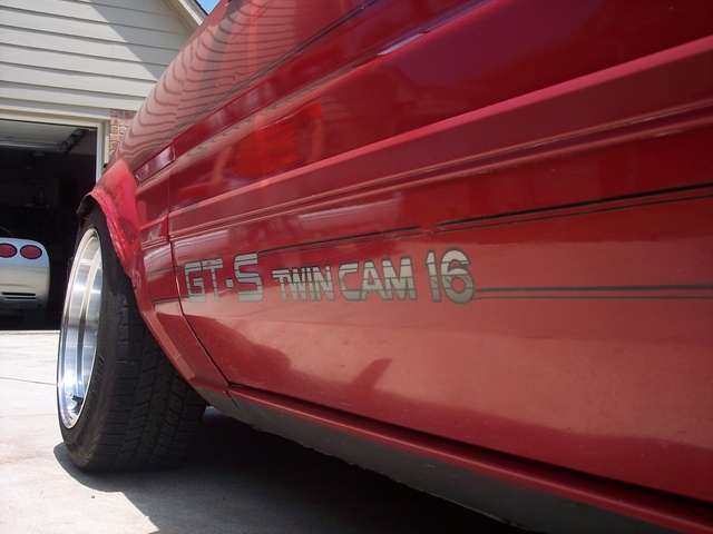

oldskull Wrote:Sportmax 002 require rolled fender. What means rolled fender ? any pics ?

It meens you have to go to that special machine shop that car roll the inner part of the fender (where it turns in).
Hope you understand (maybe someone can do it better?) danielvanderwoude Wrote:looks like the nmwisima joke saved you in the end http://www.jdmbits.com

you can even do that by yourself like this
![]() But I hope you will do it beter and clean like this 1985 AE86 (ハチロク) Levin - Summer time daily driver |

Well still dont understand what must be done if the outside must be widened or the inner of the fenders need some modify well i think i will better understand if i buy them :-) hope it will go well with 195/50 rubber because on our street is using less then 50 is killing of wheels ...really suck our roads. Too much holes.
If i see it right the 1 pic is with standard height and the red hachi has somethink like coilover setup 85' AE86 GT coupe lifetime project since 2005 |

The first pic also modified fender, but he did correctly (i think).
You can use sport max without modified your fender, but your rubber (tyres) will touch the fender. Yes of course you can use 195/50 rubber. Just buy and try it yourself. I am almost buy them too, but I dont want to modify my fender. Still like them original ![]() Oh yes, you can buy Konig Rewinds copy, the wheels named Fast Forward. They are 15x7j 0 offset. The price if I am not wrong about 480 USD for 4 wheels excluding shipping to Europe. 1985 AE86 (ハチロク) Levin - Summer time daily driver |

Konig rewind copies are a bit weird.. since rewinds themselves are already copies. Rolled fenders are fenders where the lip on the inside is bent out, and then smoothed and painted.
