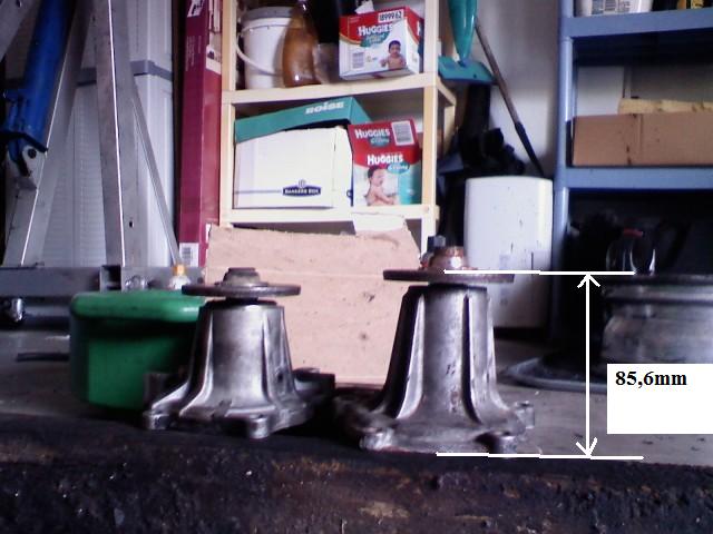

08-19-2013, 03:10 PM
water pump issues
the FWD pump on the left and RWD pump on the right.
[Image: AEU86 AE86 - water pump issues]
FWD pump with FWD pulley = correct line
RWD pump with RWD pulley = correct line

Has anyone got the lengths of the two shafts in the photo?

water pump issues
ditn Wrote:Can you use a fwd pump with a rwd pulley?
I have ordered a fwd pump for my ae101 but i will use the pulley from my old 4age
No. Look at the pulley photo, short pump with longneck pulley = line goes wrong.

08-19-2013, 04:43 PM
water pump issues
Alex170984 Wrote:Has anyone got the lengths of the two shafts in the photo?
RWD 85,6mm
