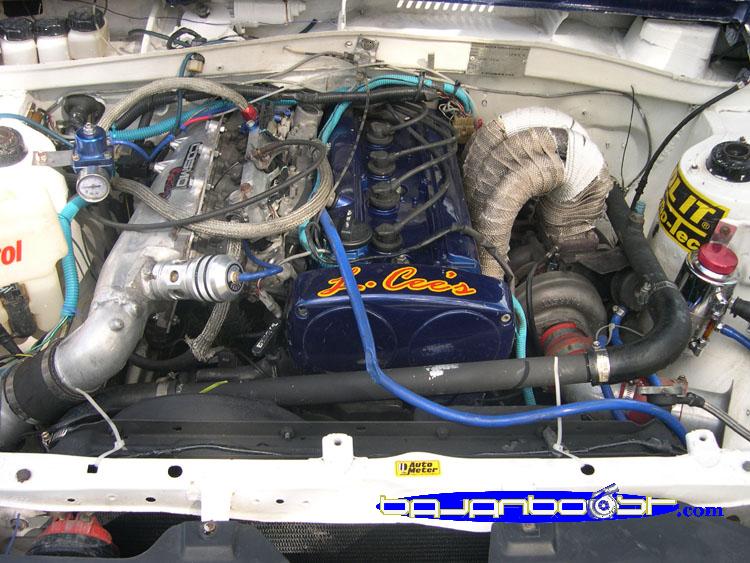

10-07-2006, 11:52 AM
turbo + silvertop = possible?
[Image: AEU86 AE86 - turbo + silvertop = possible?]
10-08-2006, 01:03 AM
see 20v + turbo isn't completly stupid.

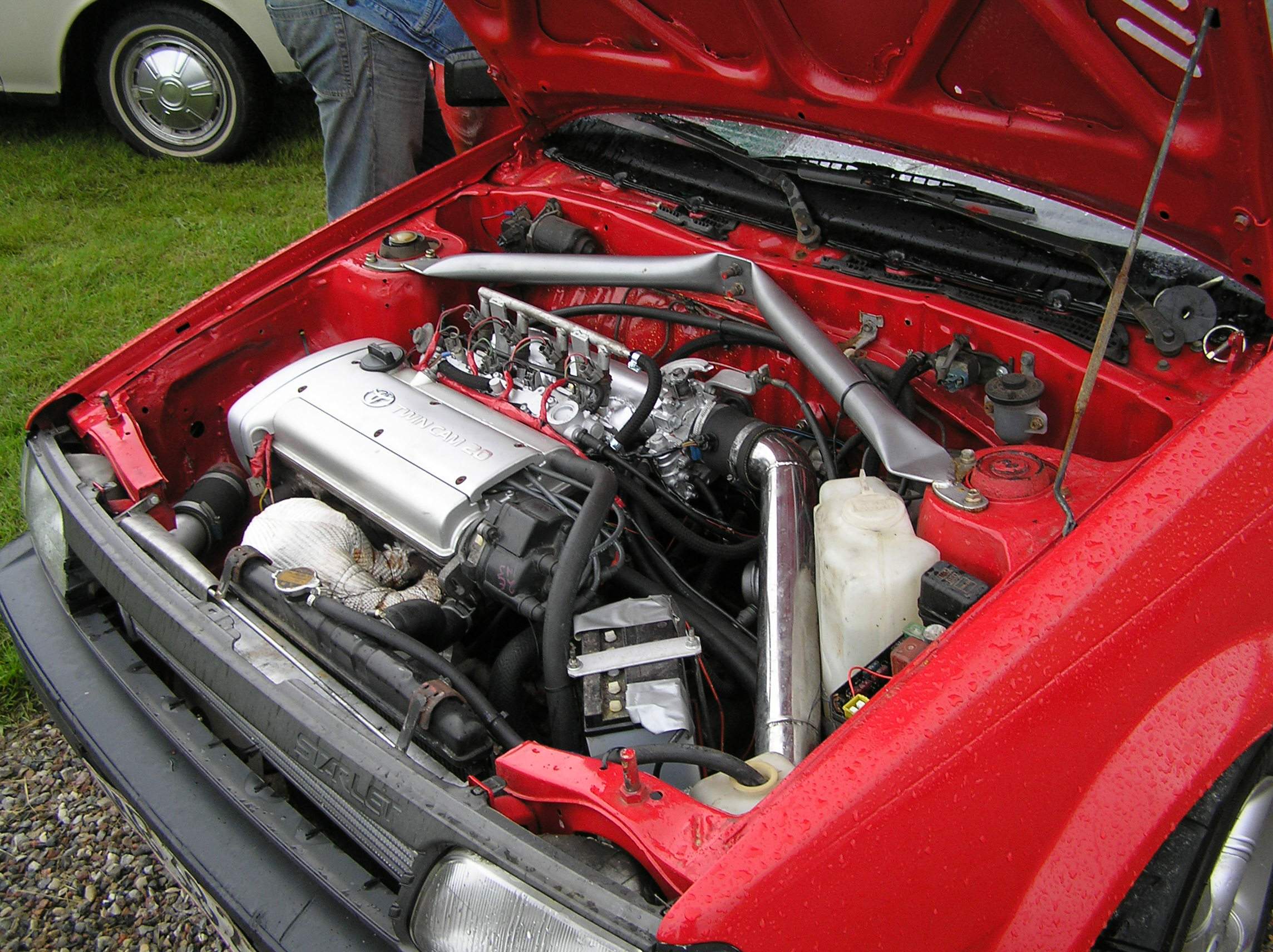

10-26-2006, 02:52 PM
Turbo on a Silvertop is not a stupid idea.
This liltle Starlet here makes 465bhp. He fitted 2 headgaskets, a homemade plenum with a large trothlebody, a homade turbomanifold, a very large turbo and a Megasquirt.
I dont have to mention, that its rather quick... Hurray!

10-26-2006, 04:46 PM
I just wunder, regarding the starlet, why did they take of the ITB“s, and run a single throttle body.
/Skassa
Any fool can go fast in a straight line.
VEMS Blacktop 4AGTE20V 272hp/350nm
"""www.turbotoys.dk"""
10-26-2006, 04:55 PM
Who needs throttle bodies on a turbo car? Seems to overcomplicate things, might even make less power than a big plenum.
