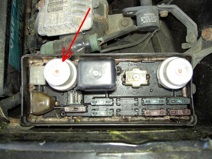

07-24-2010, 07:35 PM
start problems
I have checked today all the fuses again and they are ok
then i checked the engine for spark and fuel
spark was ok but no fuel at the injector rail so i checked the wires in the trunk at the fuel pump and they get power (12v) when i turn the contact key.So i put a battery in the trunk for to hear if the fuel pump is working and i d'ont hear nothing so i think the fuelpump is rip Crying

07-24-2010, 09:02 PM
start problems
recently i had a simlar problem with fuel...
pump didnt get any power... i changed that relay u point at pic and it works now...
dunno about heting up but maybe some short circuit?
