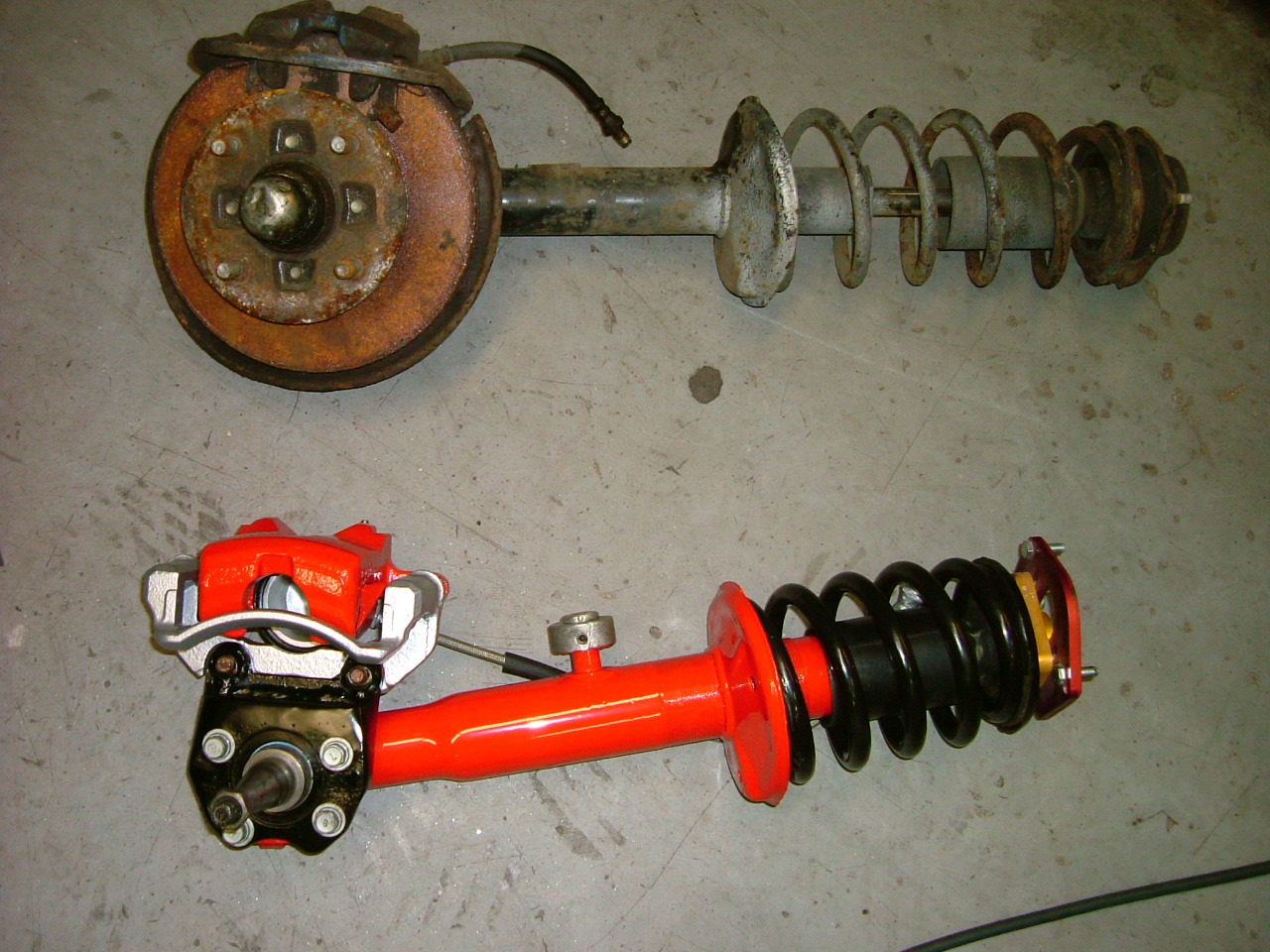

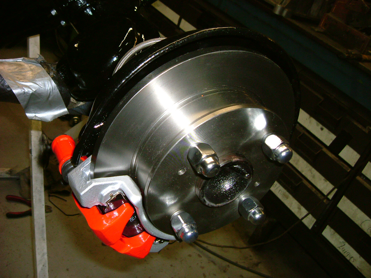

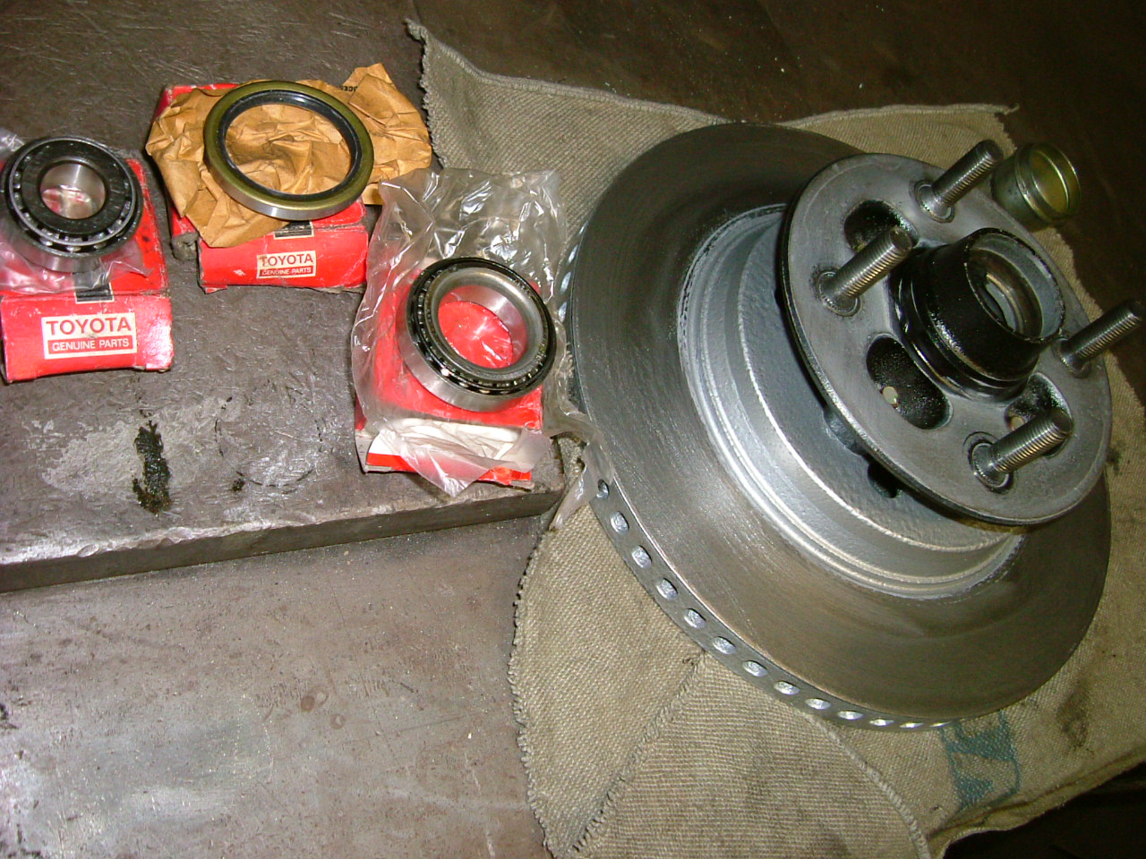

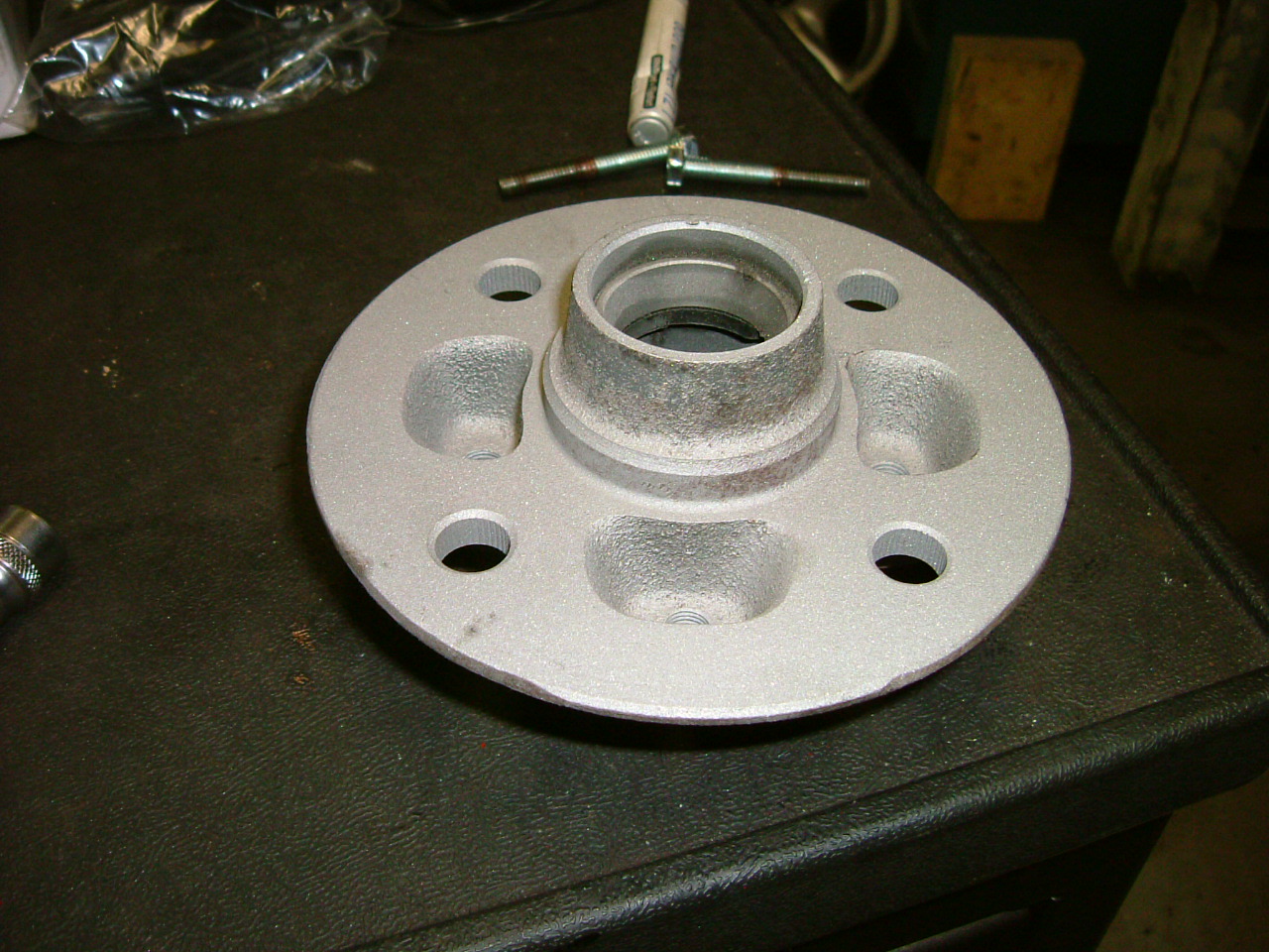

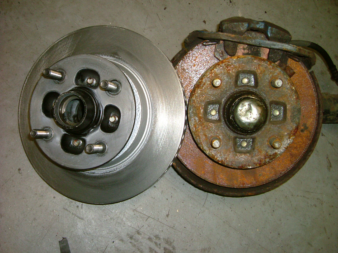

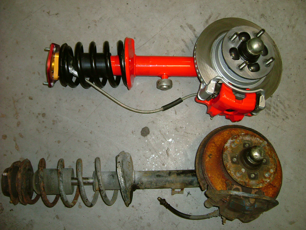

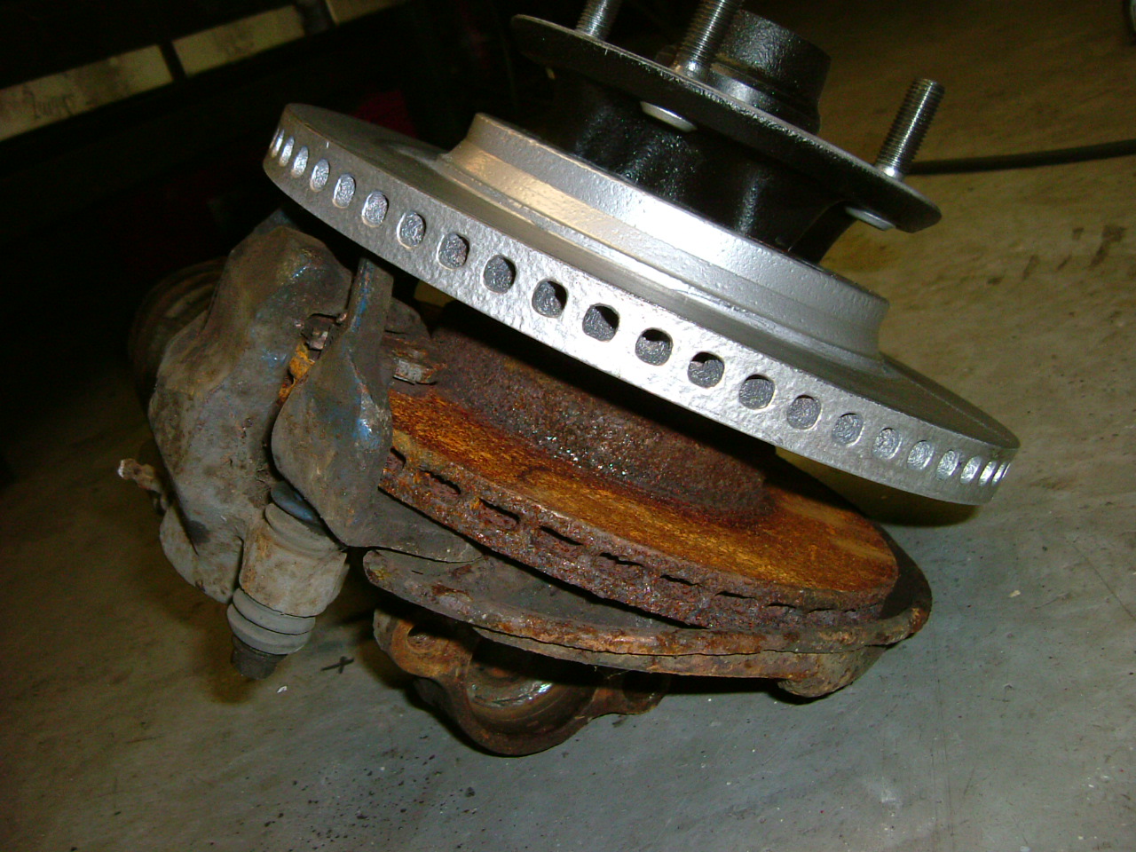

so this week i did the front struths and brakes
rebuild the brake calipers and painted them
repainted the struths into red (just like the calipers) Cool
and put in the new wheelbearings and put it all back together Smile

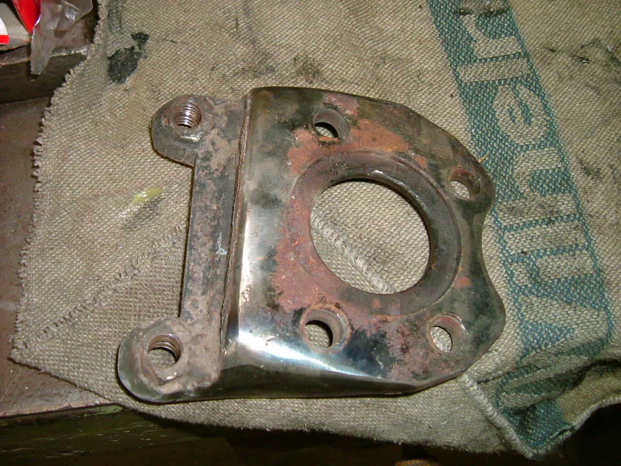

i know one thing for sure...... this brakes are a LOT bigger then the stock ones

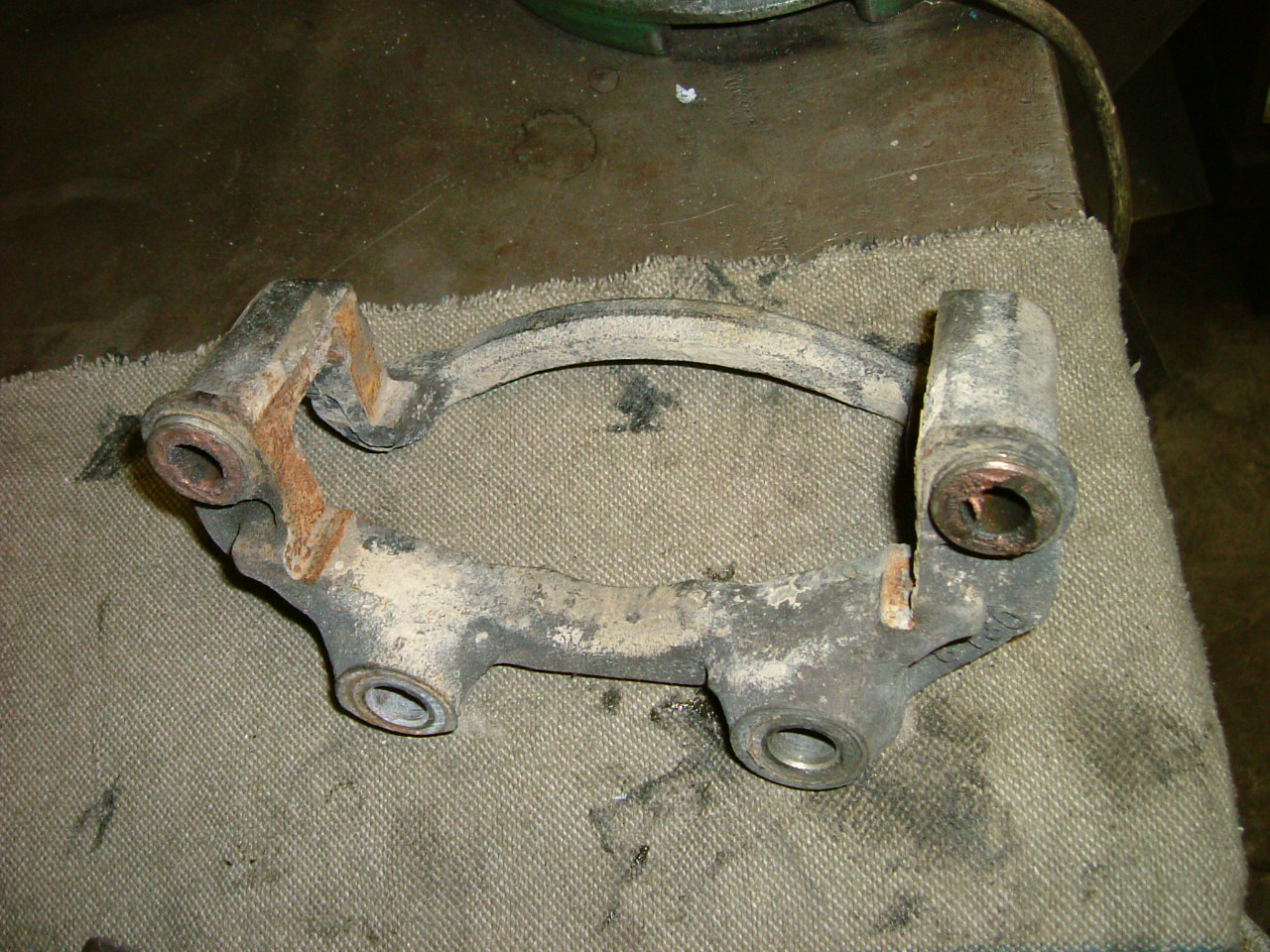

its home made and i do know that the brake pads are from a nissan sylvia s12 and the discs Confused i dont know!,not nissan Smile
and the thingie where the brake caliper is mounted on is also hand made(and remade by me to fit on the ae86 leda suspension)all the brake stuff came off an old rally TE71 thats taked apart by me
check it out!!

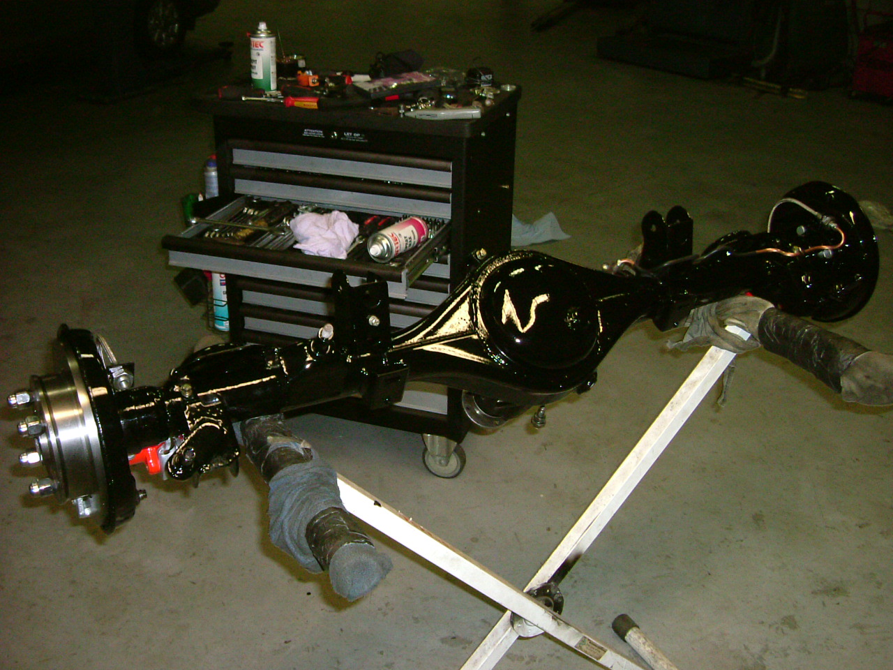

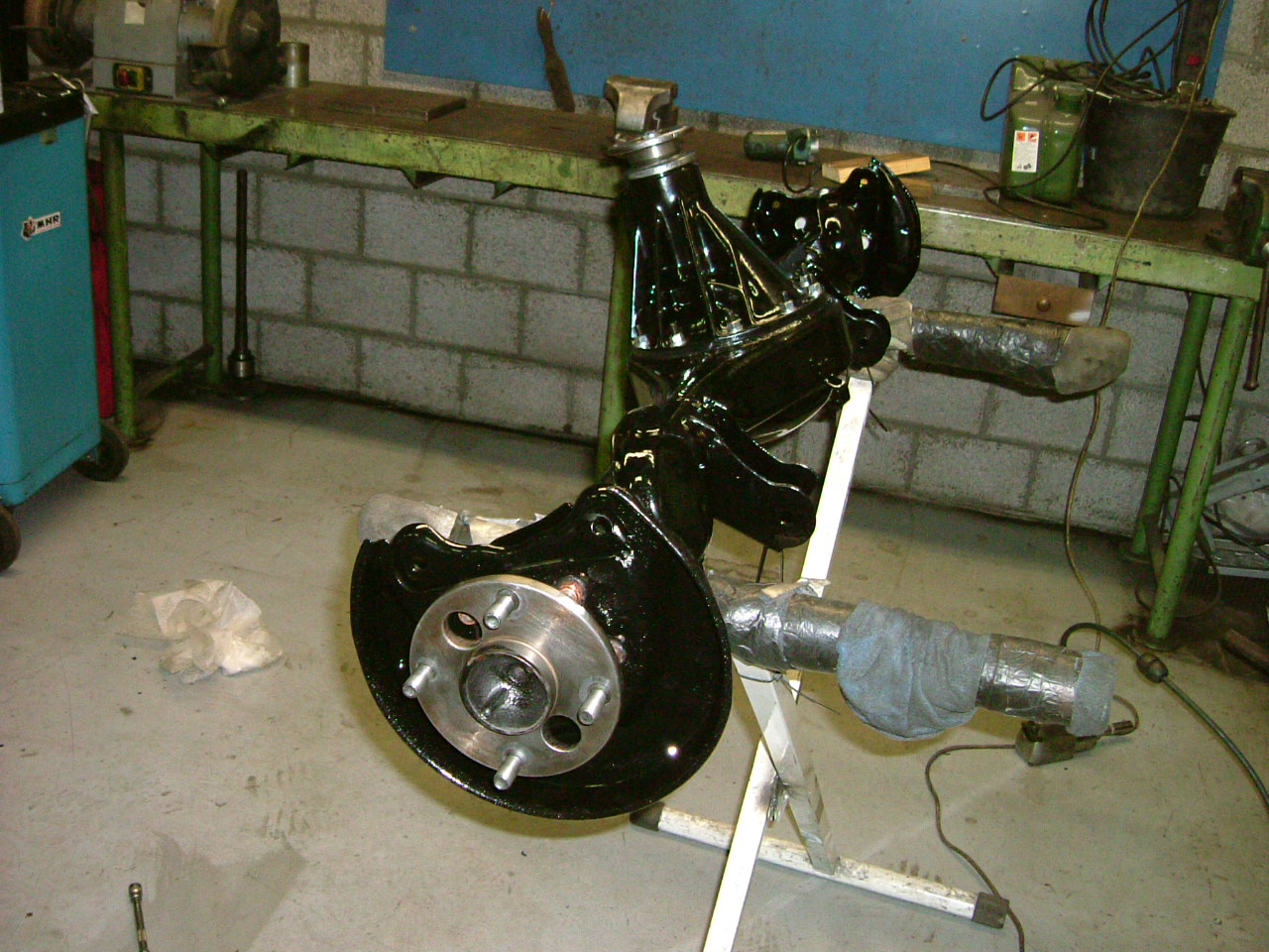

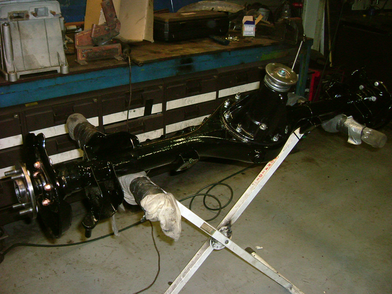

i guess i cal this the rear axle aria Tongue
the diff is ""done" also
new bearings,4.556 final gear,and the stock diff,its rebuilt butt still waiting for my trd 2 way Big Grin
then i go for the 4.7 final gear i think and i will setup a "new" diff and keep the "old" one for spare Thumbs up!
tomorrow i will put it all together and post pics Hurray!

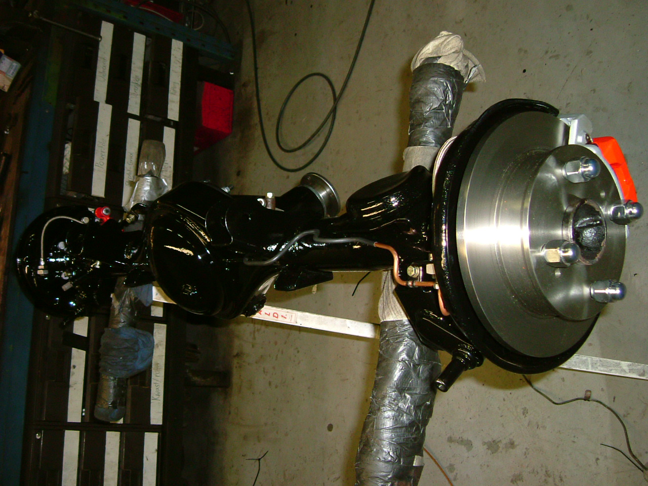

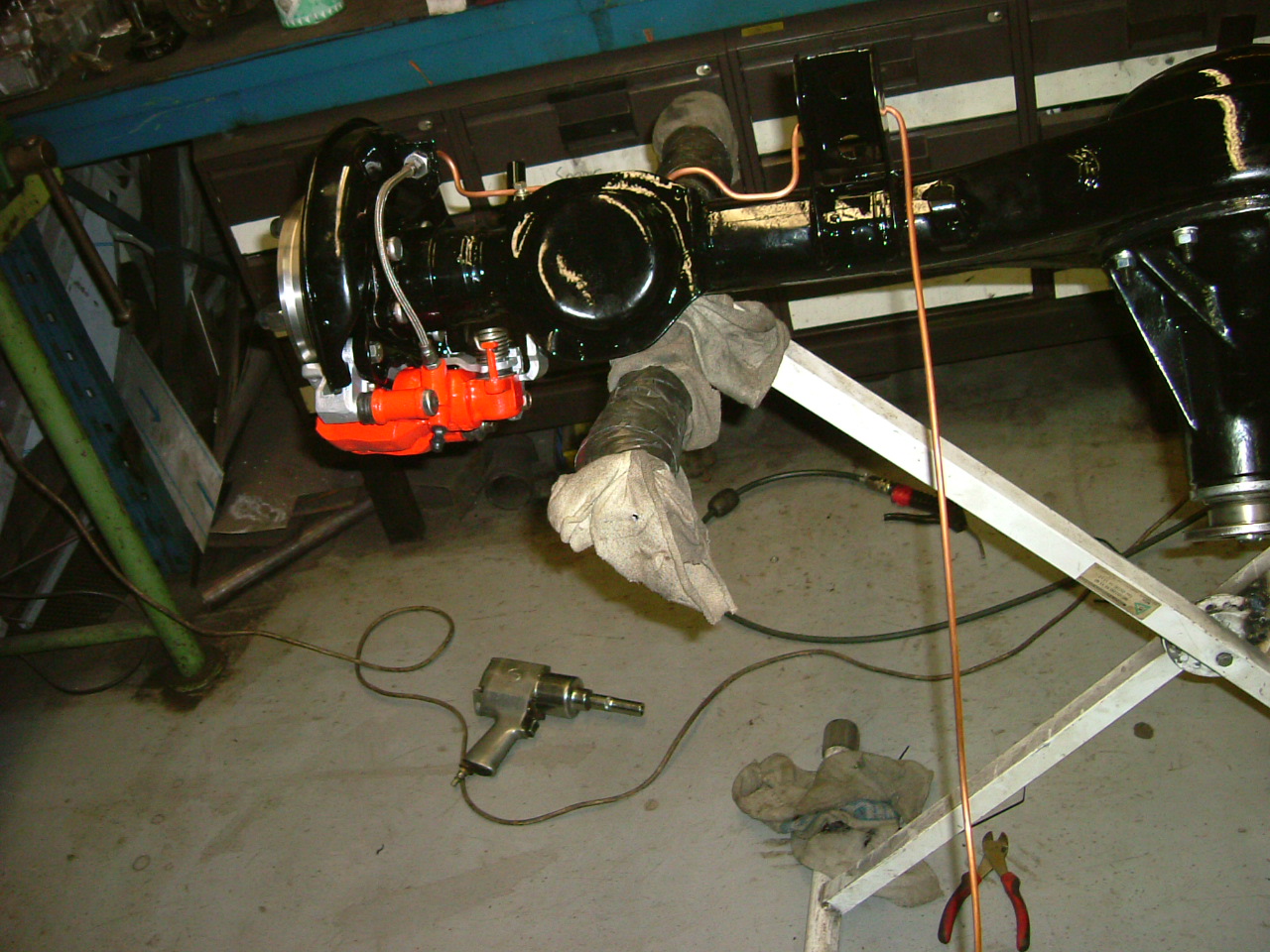

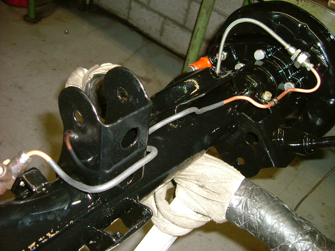

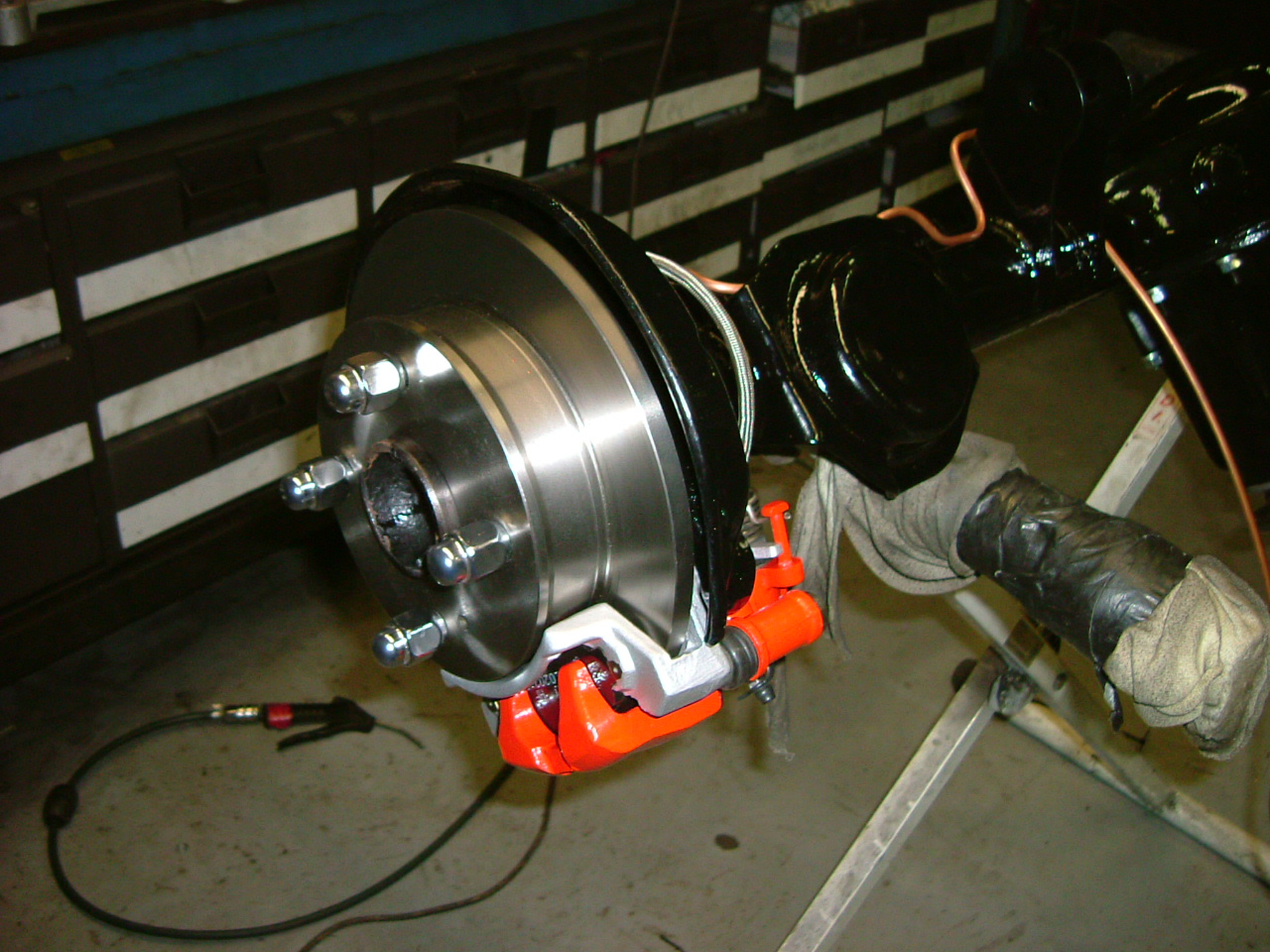

today i finished my rear axle
put the lsd back in and the brakes etc BLINGBLING Big Grin
