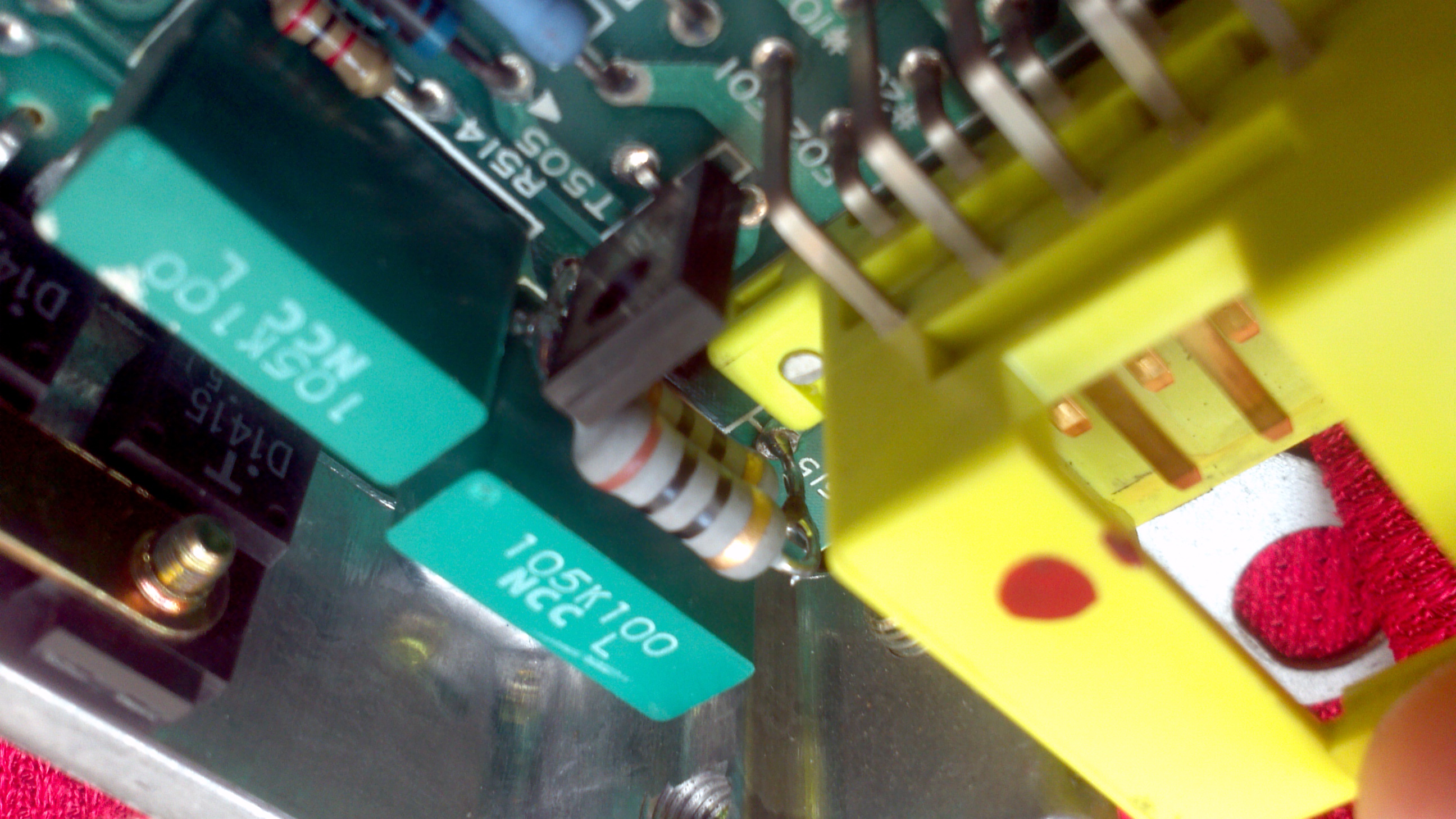

Possibly a shorted wire.. that resistor can take some pretty hefty current usually. You might want to check that before you replace it and go for a drive again.

Ivan141 Wrote:Possibly a shorted wire.. that resistor can take some pretty hefty current usually. You might want to check that before you replace it and go for a drive again. The other connection wire is +, coming from EFI relay and 10A fuse. Possibly it was a short circuit sometimes, as I found the wires have been repaired by previous owner. It seems I was driving my car for several years with out tvis working properly The ECU is in electronic shop at the moment for part replacement and test. I hope it was only the fired resistor causing the problem. Fun is not the straight line! |

The resistor is so damaged that I cannot read the resistance in ohms I need help. Can somebody check the resistance value of the R515 resistor in Ohms? Big thanks! Fun is not the straight line! |

I measured3,91 ohms. probably you need a 4ohm nominal resistance. good luck!

ZDoman Wrote:I measured3,91 ohms. probably you need a 4ohm nominal resistance. good luck! Thanks man! I'll give it to go tomorrow.

ECU is now OK! A few broken parts has been replaced. TVIS is now working properly. After first run I have noticed that BTDC has to be rechecked. Now everything is working perfectly. The car is flying Fun is not the straight line! |

ZDoman Wrote: Thanks man! I put the resistor as you said. The guy at the electronic workshop told me that any resistor up to 8 ohms will work as they are here just as precaution. Fun is not the straight line! |

Since i didnt find a 3.9 ohm resistor. I put 2 10 ohms resistor i n parallel so know u have 5 ohms. And know tvis working.Hope this helps someone...
