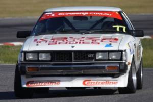

this has been on going for the last 15 years[img name=]http://www.aeu86.org/files/re/recoverd_jpg_file2223_266.jpg[/img][img name=]http://www.aeu86.org/files/re/recoverd_jpg_file4252_115.jpg[/img][img name=]http://www.aeu86.org/files/re/recoverd_jpg_file4558_202.jpg[/img]

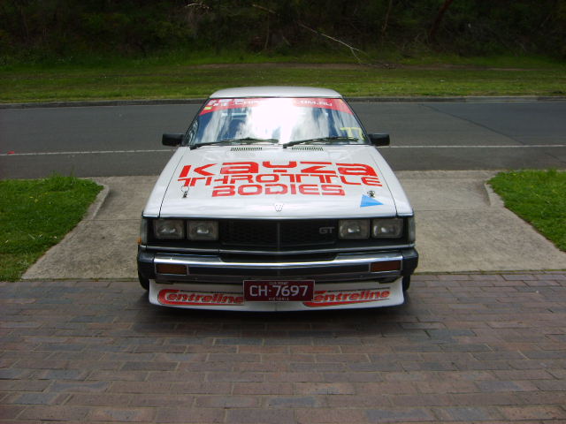

and some more[img name=]http://www.aeu86.org/files/im/img_04821_196.jpg[/img][img name=]http://www.aeu86.org/files/im/img_02001_610.jpg[/img][img name=]http://www.aeu86.org/files/im/img_01861_100.jpg[/img][img name=]http://www.aeu86.org/files/re/recoverd_jpg_file4249_330.jpg[/img][img name=]http://www.aeu86.org/files/re/recoverd_jpg_file4250_457.jpg[/img][img name=]http://www.aeu86.org/files/re/recoverd_jpg_file30_649.jpg[/img][img name=]http://www.aeu86.org/files/re/recoverd_jpg_file4_166.jpg[/img]

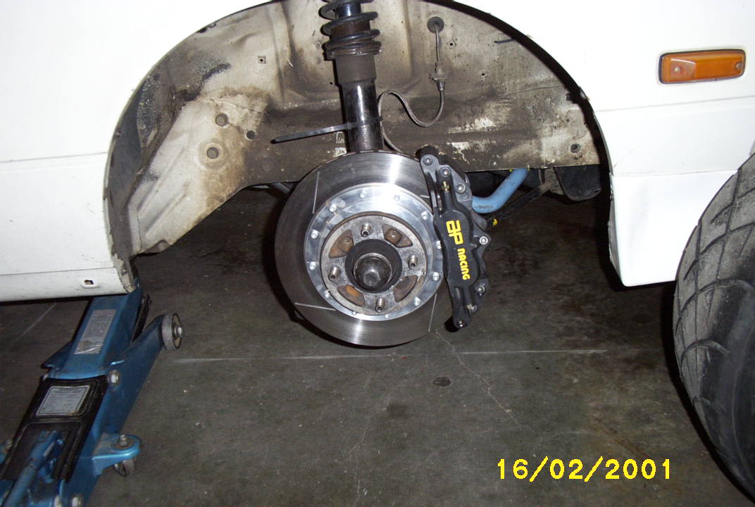

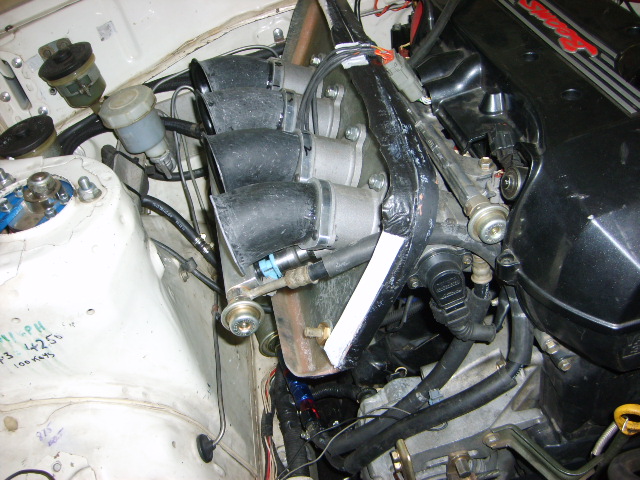

ok abit about this car its a japenese GT celica ,runs a 7.5 gt rear end
has AP discs front and rear with 4 spots on the front and 4 spots on the rear
the car weighs in at 998 kilos before i get in and retains most of the interior as per our rules ,but we are able to take out back seat for roll cage and heating etc ,but must retain headlining and passenger seat

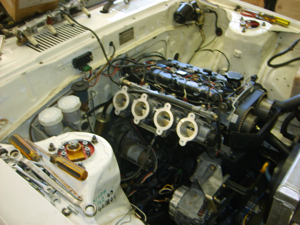

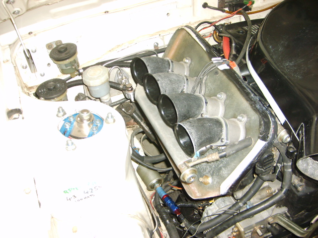

the motor in the last set of pics with curved ram tubes is the current set up
running 14.5 to 1 comp cams are 14.65 mm of lift 1 tooth of vvti on each cam 50mm quad throttles with 2 stage injection and big air box
current power is 204 kws at back wheels at 9200 rpm and motor idles at 900 rpm

Oy vey! Cool car and sweet engine setup. Nice to see that you are sticking with the VVTi. How many degrees of adjustment does the single tooth give you?
08-16-2011, 08:31 AM
my celica race car with race beams
its about a tooth and a half actully in dial indicator terms .its 240 back to 80 on the inlet and 130 off back to 70 on the exhaust

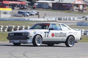

ok a few of my car around sandown and philip island

Have you tried a bigger volume airbox to see if there was any improvement as the ram stacks appear close to the lid on that version?
