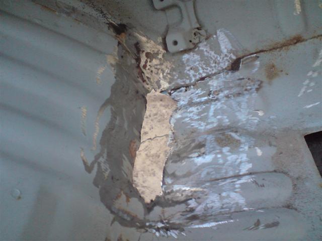

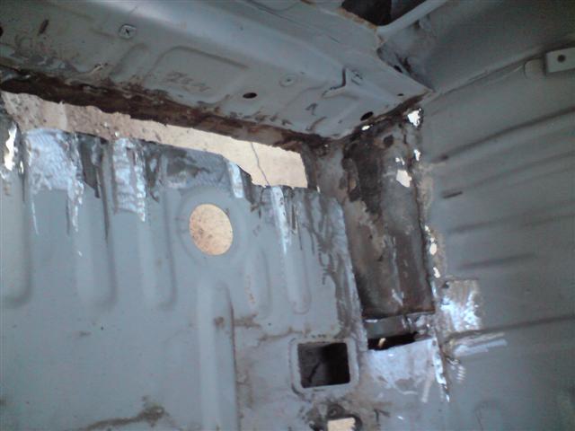

hi, i need to know what thickness of metal do i need to patch my ae86? the patch is going in the floor.
any help is great thanks Wave

Stock hachi stuff is probably around 0.7 or 0.8 mm thick. If the shapes you need to make aren't to complex then 1mm sheet metal is the easiest to work with (less risk of blow-through, nice and solid too).

Would also say 1mm but tidy up the edges of the hold first and make sure all the areas are free of any old paint and dirt for a nice weld

thanks lads, will get some 1mm stuff Thumbs up!

this may be very off topic..okay it -is- off topic...
but i have noticed something diferent about the rust in European Ae86's...mainly in the pictures posted above. The really badly rusted ones in Australia seem to never rust there in the footwell..only in the rear arches, windscreen, i could go on...but could it be different weather conditions? namely snow that causes the moisture to build up there????
