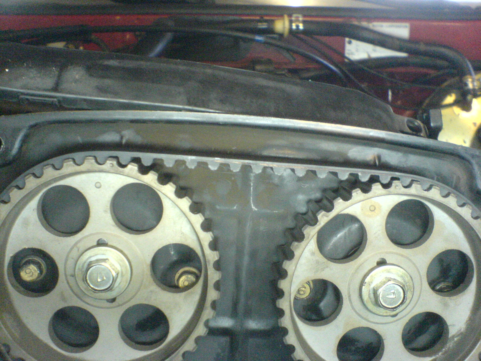

Oh and by the way, if those pics of the cams are with the engine at TDC, then something is wrong.. at least if they are the stock cams. You should be able to see a dimple in the camshaft through the oil filler hole with the engine at TDC.

ae86 Wrote:Do you have the nockpins right ?

@ivan:
looking at this picture (attachment below) in full size, you can just about make out the knockpin, according to the above pic from ae86 this is correct for TDC Confused

Ivan141 Wrote:Oh and by the way, if those pics of the cams are with the engine at TDC, then something is wrong.. at least if they are the stock cams. You should be able to see a dimple in the camshaft through the oil filler hole with the engine at TDC.
Seems that he has no stock camshaft ?, de dimple is not there the but the cams are in the right position Confused
your camshaft timing is correct!!
as far as I know they are stock - it's a non CAT, AFM equipped Swiss hatchi...
and the my pic does look very similar to this:

This dimple ivan meens
[Image: AEU86 AE86 - help, engine dies at startu... - SOLVED)]

well it's there - I can just about see it on the full size picture...

Thumbs up! i must look twice Dumb question to see it
