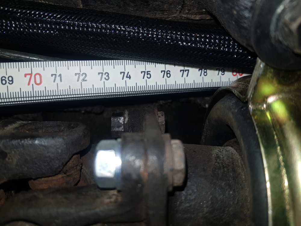

Hi,
i am currently replacing my completely broken Center Support Bearing and i found a problem.

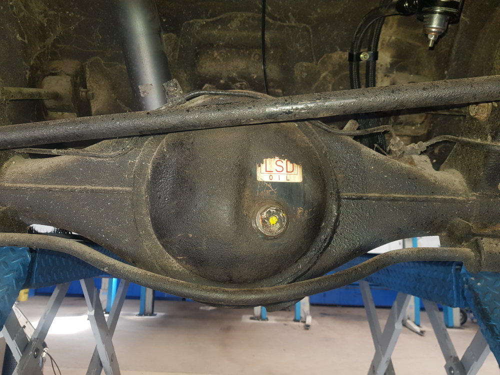

My 86 apparently was a SR5 with an 4AC Engine and Open Diff.
When i got it, it had a 4AG and an T50 Gearbox and what i think is a T Series LSD. (It says "LSD OIL ONLY" on it and has 10 carrier to axle housing bolts)
It seems that my old Center Support Bearing broke because the rear Driveshaft is too long, the new one doesent even fit the bolt holes because it needs to be moved 1-2cm to the rear.
Also the Driveshaft is completely bottoming out into the Gearbox.
I´ve done my research and know that there are 740mm and 760mm rear Driveshafts.
BUT i already have a 740 mm rear driveshaft.
I am completely stuck and have no idea what to do now.
Can provide pictures for clarity
07-04-2022, 10:47 PM
AE86 Driveshaft too long? [SOLVED]
Added Pictures

07-05-2022, 09:45 AM (This post was last modified: 07-05-2022 10:12 AM by totta Crolla.)
It looks like the axle is positioned correctly but is there a difference between SR5 and AE86 rear link arms?
Could the engine mounts be incorrect? Again, a difference between the two vehicles?
I think you need to measure between the end of the gearbox and the differential drive flange,
compare this to a known quantity (AE86)
If that measurement is correct, suspect the front part of the prop shaft.
07-05-2022, 10:50 PM (This post was last modified: 07-05-2022 10:51 PM by MyCrazyGarage.)
(07-05-2022 09:45 AM)totta Crolla Wrote:  It looks like the axle is positioned correctly but is there a difference between SR5 and AE86 rear link arms?
I couldnt find a source that states a difference between SR5 and GTS rear link arms.
I think its the rear Driveshaft thats the problem, since the Driveshaft bearing doesent fit properly. (Bearing would need to be moved back)
The previous owner DID modify the engine mounts...to a point where a 30mm washer is required to hold it. I think so he could move the engine forward so the shaft doesent bottom out into the gearbox.
But right now the engine is mounted on its original position.
I will remove the driveshaft later this week and properly measure everything.

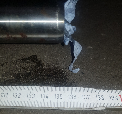

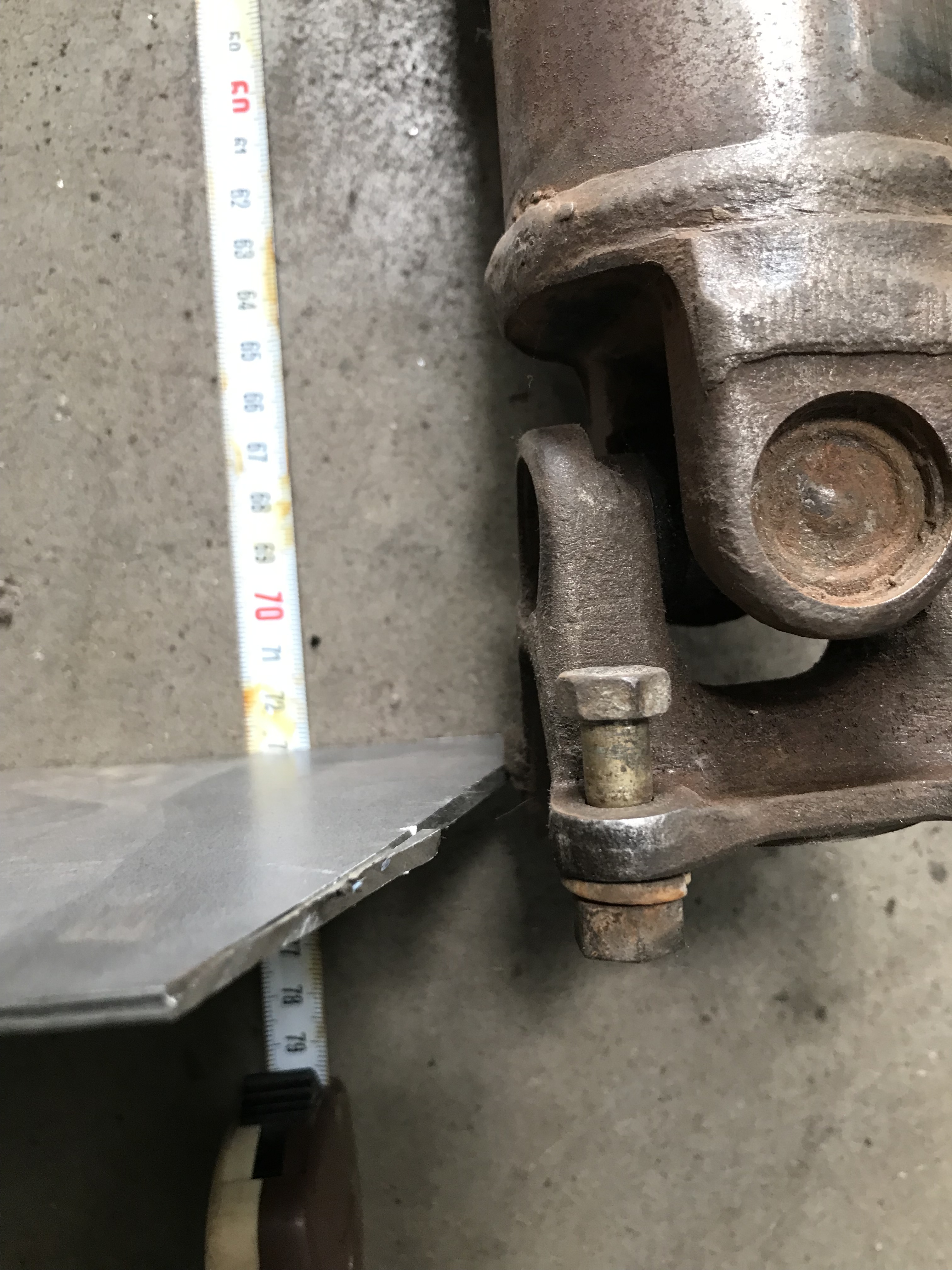

07-13-2022, 11:44 PM (This post was last modified: 07-13-2022 11:47 PM by MyCrazyGarage.)
Sorry for the wait, i tried to fix some engine problems.
So i removed the driveshaft today and measured again.
Its actually 747-750mm long. So not a 740mm or 760mm one. (Rear.jpg in attachments)
The front one is about 603mm long.
Total length about 1350mm
The transmission mount is unmodified and using the correct holes.
So it would seem that my rear driveshaft is about 10mm too long, correct?
Edit: Its a 22 Spline, see attachments

07-18-2022, 02:36 PM
(07-13-2022 11:44 PM)MyCrazyGarage Wrote:  Sorry for the wait, i tried to fix some engine problems.
Ae 86 Kardanwelle ist 1335mm lang, der Teil nach dem Mittellager ist 730mm lang
