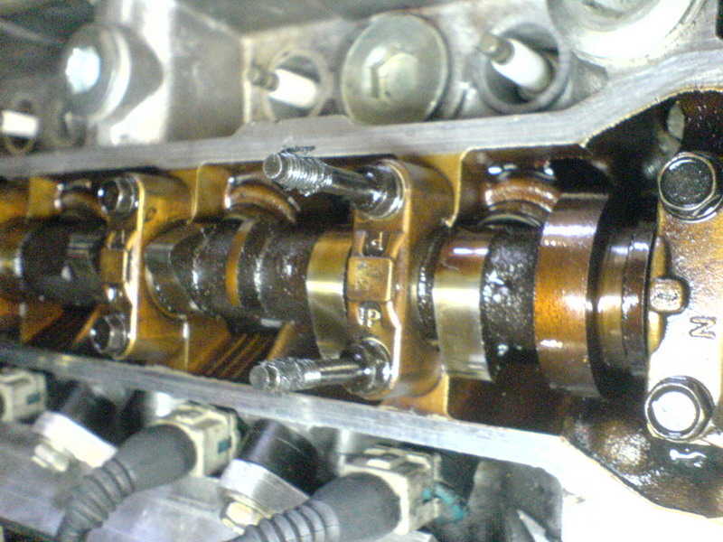

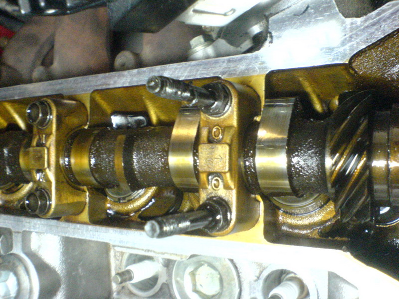

engine is still not running, here the pics as promised...
[Image: AEU86 AE86 - help, engine dies at startu... - SOLVED)]

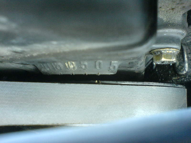

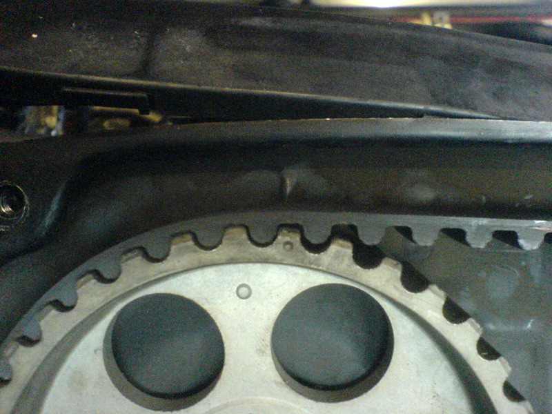

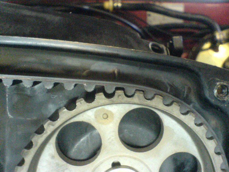

following pictures are with the engine set to TDC - have I overlooked something (hopefully yes, so I can get it running again quick snap)
any suggestions?

Do you have the nockpins right ?
One time in the past i haven make a mistake and have both nockpins above.
No compresion on all of the cill Banging head

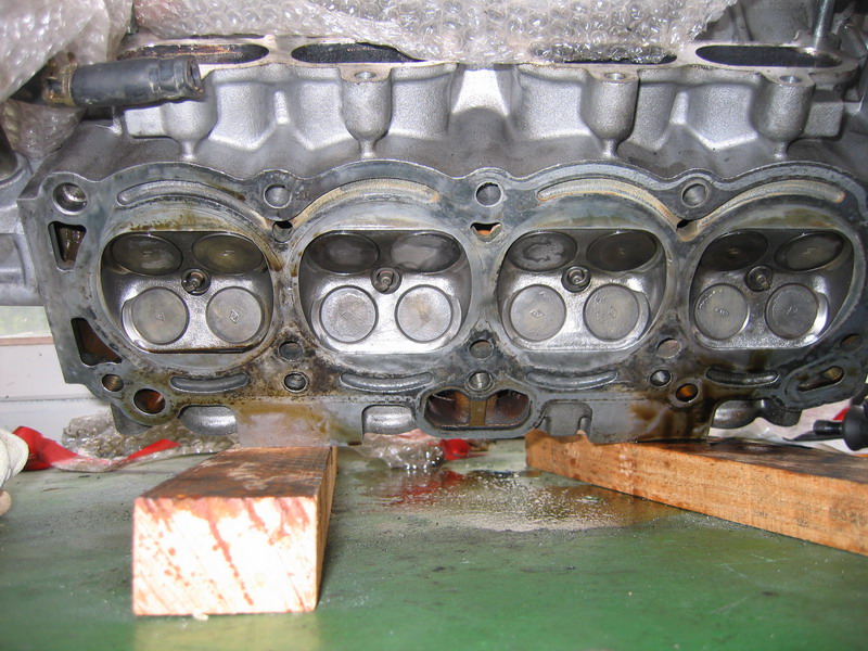

Hmm..the valves on the rightmost cilinder look a bit off compared to the rest.Almost like some coating has been burnt off, maybe it's just my imagination. Looks like you aligned everything just fine, although it's hard to tell with the distributor after it's been out.

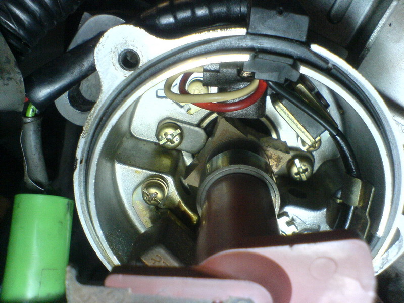

I have look @ my spare 4age.Seems like that your timing camschafts is good.
Picture of the ignitor @ my 4age, also everything on zero.

@ae86 - how can I set ignition timing without the engine runnig at least rough?
when I try to start it trys to fire twice realy short and then dies Angry
any more hints? will try a new set of plugs just in case - despite them being good...

RTFM OF 4AGE Blush
Is your distributor on the same spot as before?
Do you have the 4age manual ??
iff not send mee a PM

05-21-2007, 10:27 PM
help, engine dies at startup - (56k Warning - SOLVED)
ae86 Wrote:RTFM OF 4AGE Blush
Is your distributor on the same spot as before? yup, maybe half a milimiter different
Do you have the 4age manual ?? yes, i do
