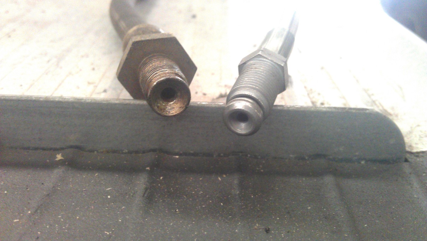

i bought the 6 line set from goodridge assuming that it was 5 lines for the brake system and 1 for the clutch.I was wrong and now im missing the line that connects the rear axle to the chassis, but that is of later concern.
The rear lines seem to fit, although i am not a big fan of the double chamfered connectors of the ss lines.In my opinion they should be an exact copy of the oem ones.This option is probably cheaper for goodrigde.

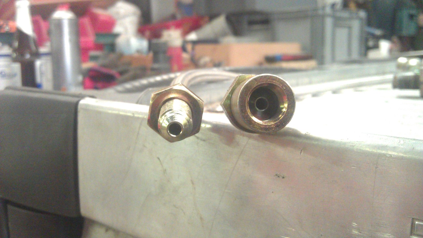

The front ones also seem to fit, my only big concern is that the connection where the 2 goodridge cables connect with each other are chamfered the same way.Im not an brake line expert but my logical thought tells me this will never seal, and if they seal they wil barely.
Am i missing something, is there something wrong with this set, am i putting them together in a wrong way?If this is meant to be this way i have more faith in the original brake lines.I also have a HEL set lying around here, fittings don't look like original as well.

Have hade the same problem before with a goodridge AE86 set, were you connect the 2 front line together. Eended up machining the the one brakeline that screws in to a 60° taper (female) to make sure it seals. Never had any problems.

fax0815 Wrote:Have hade the same problem before with a goodridge AE86 set, were you connect the 2 front line together. Eended up machining the the one brakeline that screws in to a 60° taper (female) to make sure it seals. Never had any problems.
that sounds like an assuring option, i can let them machined at my work.still i think it is a very odd construction by goodridge to produce them this way.

I remeber that now, the set were I drilled the taper, was sold as AE86, but had AE82 on packaging. Like I said, all I had to do was the taper, the rest fitted perfect in an AE86.

Im gonna get this one tapered like fax says, but i want goodridge to admit that what they manufactured is wrong.
