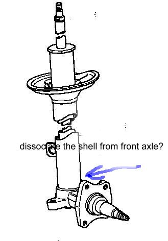

Does any body have ever dissociate the shell from the axle on a front strut?
Is it welded?or warm einforced? thanks for helping filh Filh Save the RWD cars |

There is a big fat weld underneath (inside the casting). I have never
tried to get one apart, and I imagine that it would be impossible without destroying the end of the tube. Cheers... jondee86 The reasonable man adapts himself to the world; the unreasonable one persists in trying to adapt the world to himself. Therefore, all progress depends on the unreasonable man. |

Thanks ,
I saw,not long ago on the web front axle for sale , but can't remember where (getting old :wink: ). I want to do that to save my coilover strut , but one axle is very badly bent. regards Phil Filh Save the RWD cars |

The part you need might still be available from harry hockley in the U.K
http://www.hh-ms.com/ They once manufactured the group A front struts. Anyway gotta be worth an e-mail !! An analogue brain in a digital World |

I'm now looking for steel coilover sleeves . As i wanted to use my old coilover struts , I've order Springs from Passracing (Swift 7kg ID 65MM 11In lenght). But , by checking the old strut , I 'v been disapointed : one of the axle is also bent . I can't use it. I'd like to find steel coilover sleeves to weld on stock strut , as I'm using Tokico blue (48511-AE891) with stock lenght . Any links welcome Please help an old lonsome rallydriver , lost in far Belgium Filh Filh Save the RWD cars |

I have seen the stub axle section sold new on yahoo auctions a few times
maybe check this link http://search1.auctions.yahoo.co.jp/sear...0jp&mode=2 |

thanks for the link here is the part:
But buy on Yahoo auction is another thing ..... Not really easy to read Japanese... but thanks whatever Filh Filh Save the RWD cars |
