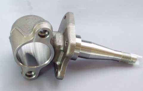

01-03-2008, 02:10 AM
front strut shell
thanks for the link here is the part:
But buy on Yahoo auction is another thing .....
