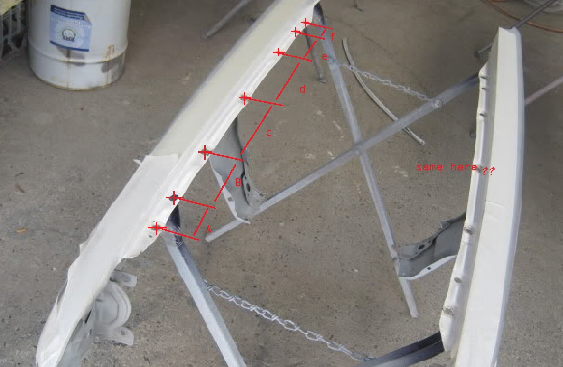

hi guys
hope an ae86 fan could help me with this issue
very simple indee
can someone please measure the holes center to center or measure between nuts
here is a pic[img name=]http://www.aeu86.org/files/tr/troubelfender_ae86_650.jpg[/img]
++if you have the fender out just do the measure from the center as the pic
or if you have it on the car,just do the measure on top and on the center of the nut
++I think is very important not have had a crash cause maybe that can vary the measure
what do you think?
but most important for me is the measures
A=?
B=?
C=?
D=?
E=?
F=?
i think the other fender MUST have the same measures right cause in mine doesnt
cheers guys
HELP!!! Sad
p.s
OFcourse more than 1 opinion and member help will be really apretiate it.

i'm going to take those meassurements you need after x-mas

A= 60
B=115
C=175
D=200
E=125
F=60
in mm measured from a Trueno wing, but its the same has a Levin, cause I had Levin wings before and they bolt in the same holes.
Same on both sides

yeah its the same wing trueno = pop up lights , Levin = fixed headlight version of the ae86

i cheked the measures some mm out of distance but...its good i can find a nominal value between the fender and the base
thnk you
