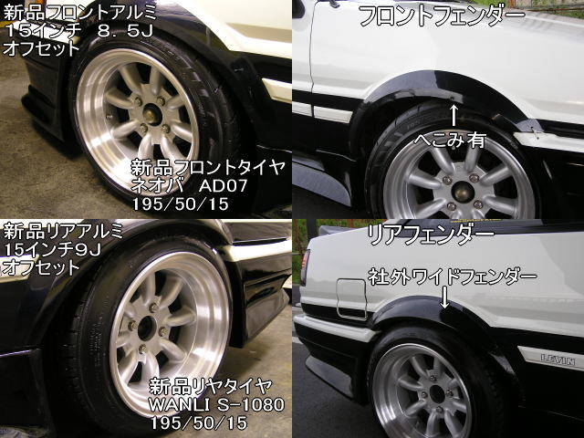

So here is the my best. Could you tell me or guess the sizes of the rims?
[Image: AEU86 AE86 - Fender & Rims Combination]
03-03-2009, 07:11 PM
Would say 15x9 -13 out back and 15 x 8 -0 in front give or take half an inch.
Djexor is the man to ask, but judging by there catalogue that would be close . I know my 8.5 0 offsets hit the strut but 7.5 +6 clears with 5mm but doesnt really sit out enough. Someone will correct me if im wrong.
03-03-2009, 07:16 PM
I'd say 15" x 8.5" i'd reckon. There defo alot wider than my rims and mine are 15" x 6". TBH i'd thought i'd be tagged on the wheel somewhere the width, and of course the tire will say rim size too. That's just a guess by me.
AE86 FTW!
03-03-2009, 07:21 PM
RS Watanabe
9J -13 at the rear
8,5J -6 at the front
tiresize 195-50/15 all around
03-03-2009, 07:34 PM
Well, I was close Smile
03-03-2009, 07:40 PM
I was right with the front width. Tongue
AE86 FTW!
03-03-2009, 07:52 PM
you 2 together are a good team Smile hachirokuGTV was right about the rear and DJMartin07 was right about the front Thumbs up!
