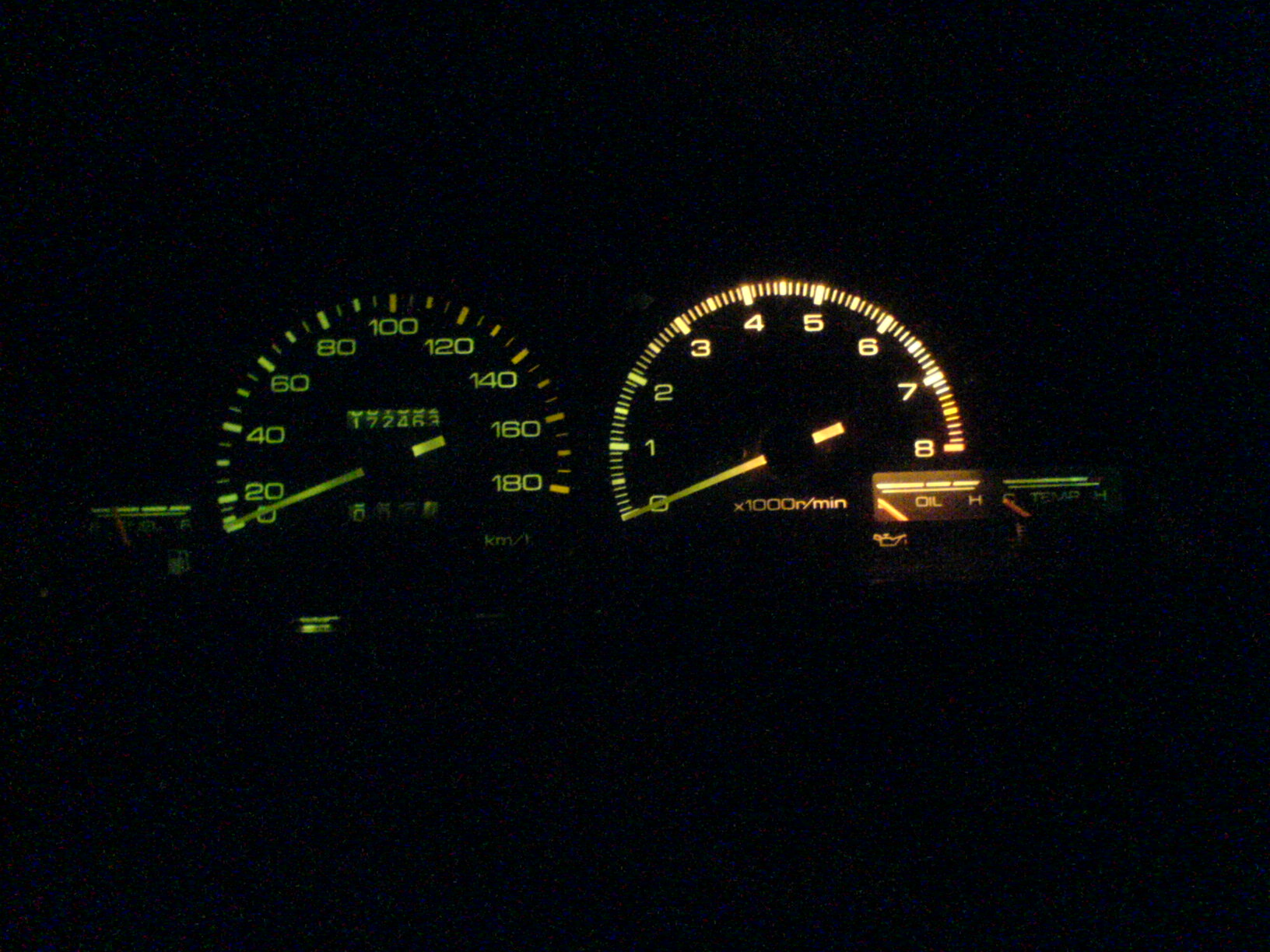

managed to sort half of the dash now, the rev counter lights up thats the important bit sorted
now jst need to sort the speedo out, its not the bulbs i replaced all of those

dash lights problem
I some of the lights work it's probably not the rheostat, if that would fail none of the lights would work. I guess the rheostat works for the rev counter lights, right?
02-04-2007, 09:59 PM
dash lights problem
actually scratch that
checking it aty night when it is dark might be a better idea
all my dash lights now work Big Grin

The dashlights are indeed a bit dim. Wink

they just look dim in the picture
took with my phone, they are lovely and bright in person
