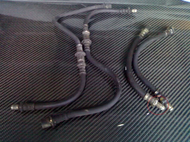

don't kniw if this is the right forum but anyway
between the brakeline and the caliper sits an "adapter", a smaller thread with a nipple goes in the brakeline and the other bigger side into the caliper hope you guys know what i mean i need this "adapter" but can't find it, even at toyodiy Any ideas? |

brake caliper/line fitting
i marked the male end, that screws out of the hose
no my calipers are original Lajoosh, what? |

The end fitting should be a one-piece item, swaged onto the end of
the hose. Like this... If it came apart, you either broke it, or it was a non-OEM hose made with screw together fittings (and I wouldn't trust my life to that kind of DIY brake hose). Cheers... jondee86 |
sounds like i need to get new brakelines
i got aftermarket braided lines on the car since i got it, but dont know what brand, something from japan i guess. it's not DIY and they always worked as they should even on the track |

Eifelaner Wrote:i got aftermarket braided lines on the car since i got it,This is most likely the answer. If the aftermarket lines did not have the right fittings on the end, whoever put them on installed the adapter to match them up. If you need to replace the adapter, you need to talk with a specialist brake shop, and see what they have on the shelf. Cheers... jondee86 |

i just gave it a shot on saturday and grind the mashed part of the nipple of, screwed it together and it seals
