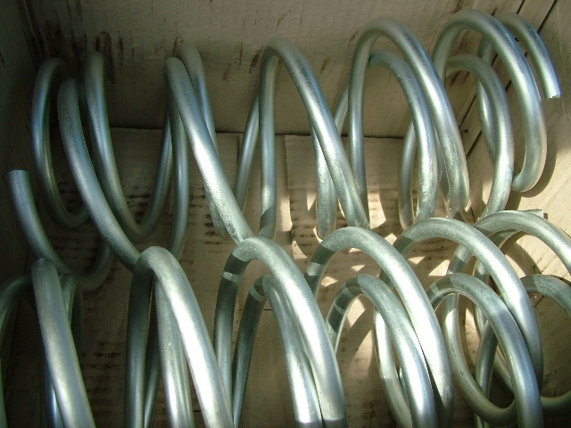

05-02-2007, 04:28 PM
aftermarket springs
I made a custom springs. In fact, it's a copy of KONI 2220-1056 springs with a little modification of rear springs – they are longer for 15 mm. The wire diameter is 12 mm.
I borrowed original springs from my friend's ae86. Zn - galvanized for rust protection.
All included 115€.
Car has approximately 2 cm of drop, and it is stiffer then stock. It’s a very good solution for everyday ride and cheap one also.
Fun is not the straight line!
