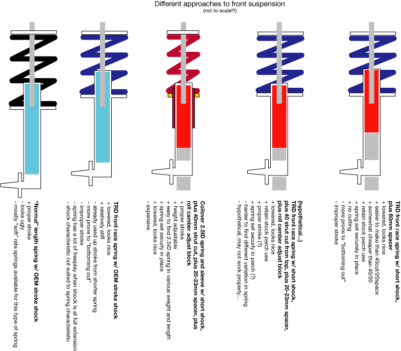

This is a pretty cool picture I found on Club4AG forums - shows the most popular ways that can be used when modifying the struts for new shocks and springs.
As you can see, it's a good idea to both shorten the strut slightly and then use a small spacer under the shock. Cutting the whole 60mm off the strut would probably drop the car too much to be comfortable in street use.
01-11-2007, 01:41 PM
ae92 shocks
I use AE92 front inserts.
AE86 housing was cut 30mm. I use 30mm steel inserts under shock inside shock housing.
01-11-2007, 01:48 PM
ae92 shocks
My springs have lowered the car about 4cm so i think i'll follow your method Jammie !!! :wink:
01-11-2007, 02:50 PM
ae92 shocks
so what if u use the new t3 to spacer would u still have to use another spacer under the shock ? Dumb question
[Image: AEU86 AE86 - ae92 shocks]
01-11-2007, 02:53 PM
ae92 shocks
Firehawk, very cool picture! really sums it up very nicely!
01-11-2007, 02:57 PM
ae92 shocks
mr monster Wrote:so what if u use the new t3 to spacer would u still have to use another spacer under the shock ? Dumb question
http://samodisel.lorddigital.com/razni/A...C_3422.JPG
http://samodisel.lorddigital.com/razni/A...C_3423.JPG
This is CLOSE-look at the under-shock spacer (this particular one is in Mux at the moment, you can see small picture in his project thread).
01-11-2007, 03:09 PM
ae92 shocks
i 've already installed the T3 spacers so the only thing to do is cut 3mm of the strut on the upper section ?
