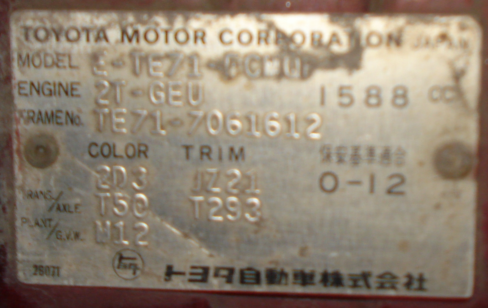

What is the axle. T293
Is there LSD in this AXLE. or not???
[Image: AEU86 AE86 - What is the axle. T293]
http://ae70.blogspot.com/ & http://drft.io.ua/
11-20-2009, 07:23 PM
The code says YES Smile
By this reference:
http://www.usa7s.com/vb/showthread.php?t=2681
http://akb.norbie.net/Public/AxleCode.aspx
Trans / Axle: T50 T293
6.7" ring gear, 4.10 gear ratio, 2 Pinions / Yes LSD
Congratulations Hurray!
