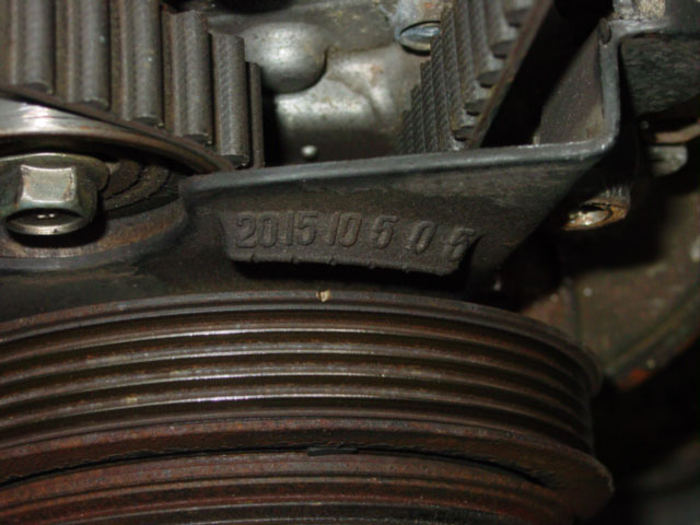

But there is further mischief here. I put the car in neutral to get the camshafts to line up. I'm not sure if the pictures will tell the story right but anyways, the left camshaft indent is at the top but the right camshaft indent is slightly to the left. The timing is set to 10 degrees, I'm assuming hte right camshaft will be to the top if I rotate the pully to 0 degrees.
Is this right? Or did someone incorrectly place everything?

You have to remove the crankshat pulley before you remove the lower cover. The crankshaft pulley might be hell to come off so you might need a special puller which has two bolts that screw into the pully. :o
I had real problems to remove my pulley when I changed the belt on my car a while back. Angry
Also the camshaft alignment marks ligne up with the two dots that are on the cover that sits behind the camshaft cover. You can see them right above the two circles you did in your picture.

Remember I told you to check that the indentation in your camshaft is visible through the oil filler opening? Align the pulley to 0 degrees and everything should be lining up to the correct marks, which are indeed lokated on the backing plate of the camgears. So remember those 3 thing to look at: indentation in camshaft, crank pulley and camgears.
Are you having trouble removing the crank pulley itself or just the bolt holding it on? If it's the bolt that's troubling you find a wrench with a long "arm" and put it on the bolt with the arm facing the correct direction, so that it is stopped by the ground..then blip the starter and it should come off. If that doesnt do the trick airtools always do.
