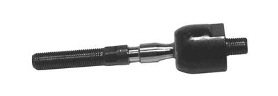

I always felt that my steering was a bit loose.
Apparently my inner tie rod on the right side is worn out and has a lot of play.
I am going to replace them both and wanted to add a 5mm spacer aswell for more angle.
I have 2 choises:
1: buy nipparts inner tie rods and add some washers to make a 5mm spacer
[img name=]http://www.aeu86.org/files/af/afbeeldingaspx_137.jpg[/img]
2: buy the new megan racing inner tie rods which already have a 5mm spacer on them.
[Image: AEU86 AE86 - Tie rods]
The nipparts cost about 50 euro.
The megan 120$ plus shipping would come to around 120euro.
I am just wondering about the quality of the megans compared to the nipparts...is the 70euro worth it or not?

Have no experience with Megan.
There are also others building those like JIC (265.- Chf), Noby Booth.
JIC will be very good quality. Thumbs up!
Just to give alternatives.
The nipparts with your own spacer could also be a good choice.

i would just run standard ones just with a spacer... cheaper, quality would be no worse then megans, most likly better...

The tie rods pictured just look like standard ae86 with a section machine down to produce the extra area for the rack to move. Powersteering ae86 tie rods are 5-10mm shorter depending on manufacture than non powersteering ones. 70 series are 15-20mm longer than this again.
heres is a pic but do check with your manufacture or No Hachi if its the case there.
http://img229.imageshack.us/img229/5863/...703vo2.jpg

Just use stock rods, and buy my precision engineered Battleversion 5mm spacers for £20 inc shipping!
Dont use washers, they have slop and can help the tie rod work loose!!!

Alex pfeifer: "Just get 4 14mm split lock washers. Put 2 on each inner tie rod. Done and done."
:wink:
02-02-2008, 05:52 PM
Tie rods
Bubble_Drift Wrote:Alex pfeifer: "Just get 4 14mm split lock washers. Put 2 on each inner tie rod. Done and done."
:wink:
Haha... not really. They will be a sloppy fit, and you dont want any squirming between a tie-rod and a steering rack Wink
And you forgot the Loctite Wink
Totally your choice. But if you want a proper, riliable, precision fit, buy the Battleversion spacers. I still have 2 sets left Smile
02-03-2008, 12:40 AM
Tie rods
They fitted fine. And I didn't forget the locktite. :wink:
For those wondering: When you use a spacer the locking rings become useless, so you need to use locketite on the thread of the tie rod that goes into the rack.
PS: Alex Pfeifer = Battleversion!
02-03-2008, 01:07 AM
Tie rods
So if i use 70series tie rods which are 20mm longer than OEM do i get extra lock?
Or i got it wrong? Confused
02-03-2008, 11:57 AM
Tie rods
You got it wrong, the extra lock comes from the added lenght of the spacer on the steering rack that can be pulled into the housing.
