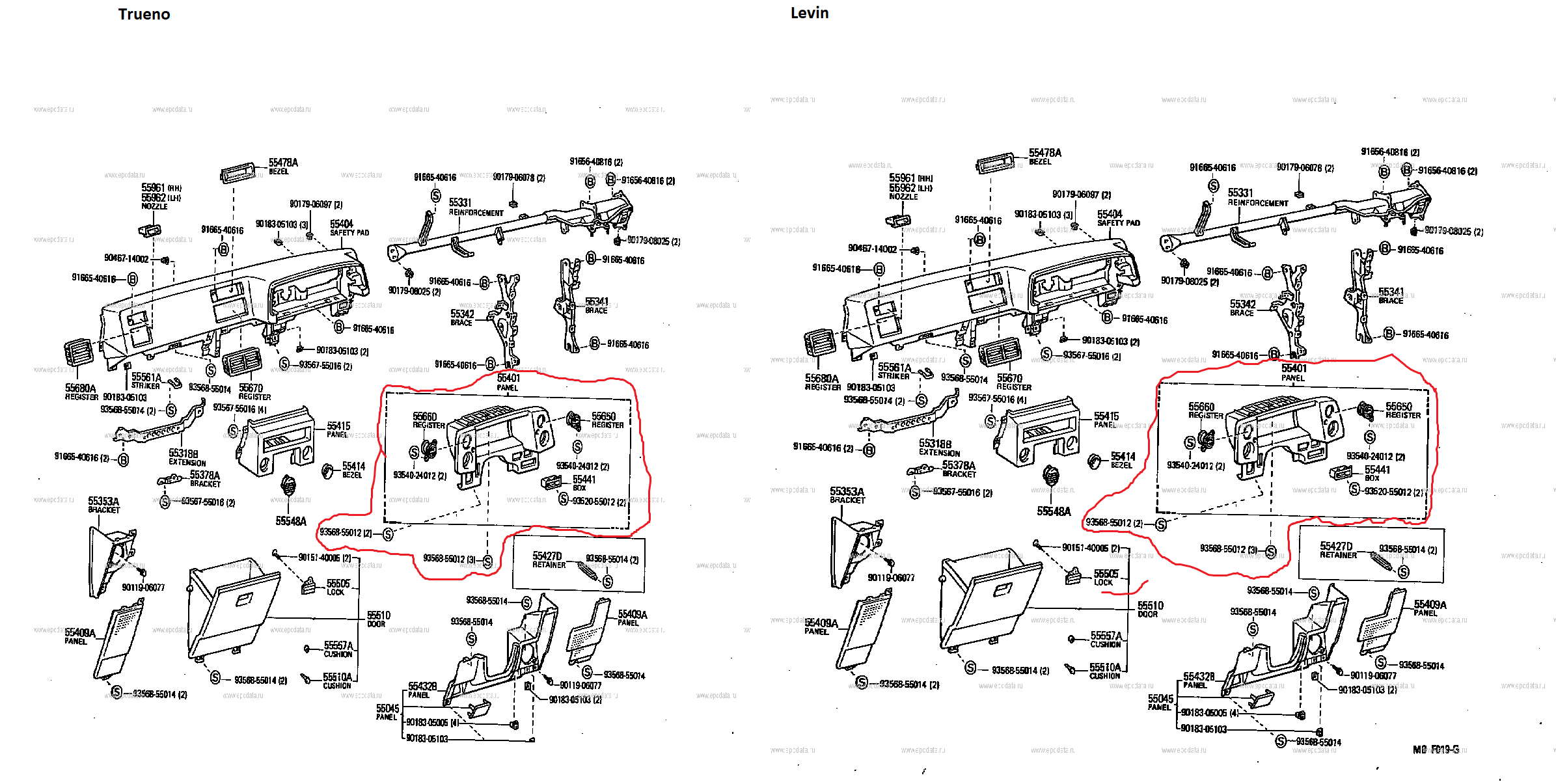

I have a question regarding the subpanel and it's rotary buttons. Both the Levin and the Trueno have different sub-panels, because the headlights switches are different and rotary buttons as pictured below. My question is: do I need to replace the sub-panel and rotary-buttons in order to get the pop-up headlights working?

Blueprints panels:
[Image: AEU86 AE86 - Sub panel and rotary-button...conversion]
I hope you can help me!

10-12-2021, 08:30 PM (This post was last modified: 10-12-2021 08:30 PM by banpei.)
Sub panel and rotary-button replacement for Levin -> Trueno conversion
You don't need to replace the whole bezel as it's 100% (mechanical) identical. The only difference is the headlight position signs.

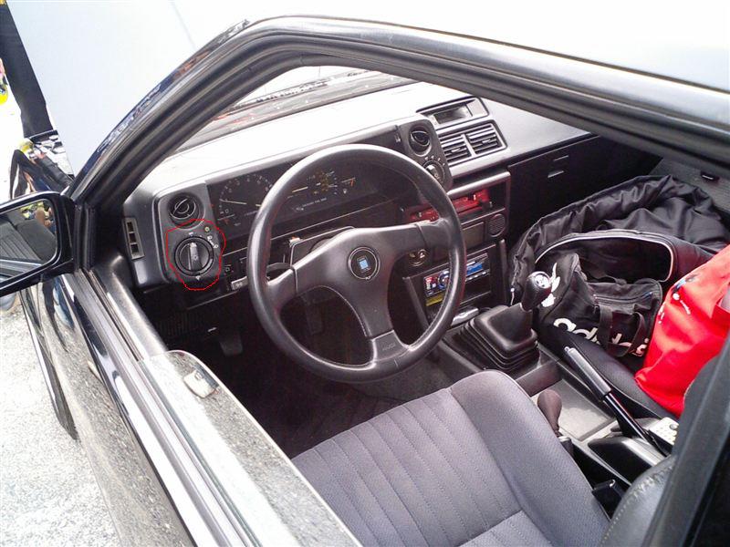

I also think they are 100% the same as the RHD ones, but then the signs for headlights and wipers are swapped.
