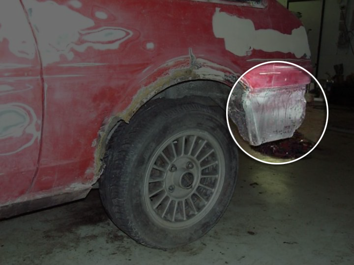

Just wondering - what role do, if any, the rear corner box sections which are usually hidden below the rear bumper (see the photo below) play in the structural integrity of the car's body? Would it be possible to just remove them and then weld in some sheet metal to fill the open bottom? A small triangular support could be added in its place to support the rear bumper's sides. As far as I can see, the body of the car wouldn't lose any of its rigidity, despite the rear corners being absent.
Apparently, at some point these boxed sections have rusted through on my car and have been repaired with some sheet metal. They have then been covered with body filler and it seems that the moisture trapped underneath it has already started to rust the sheet metal again.
Removing the boxes would allow water/dirt to be thrown from the rear tyres to the inside of the rear bumper but I don't see that as much of a problem on a race car that's driven exclusively on asphalt-covered circuits. I haven't found any high-res photos of the SS Work's N2 AE86 which has a tubular subframe at the back of the car but from what I can see, these boxes have been removed and just a small support added for the bumper.

Anything aft of the rear wheels is just there for crash safety..no problem in removing them.

I chopped them off mine but replaced them with sheet steel! I modded them not to hold lumps of dirt etc as my car is used on road rallies in the forest etc! Not structural as far as i can see!

All right, thanks! Looks like if I cut them off from the floor level, there'll be left just enough of them to support the top of the bumper and all I need to add is a small support for the forward edge (which will be left under the N2 flare anyway).
