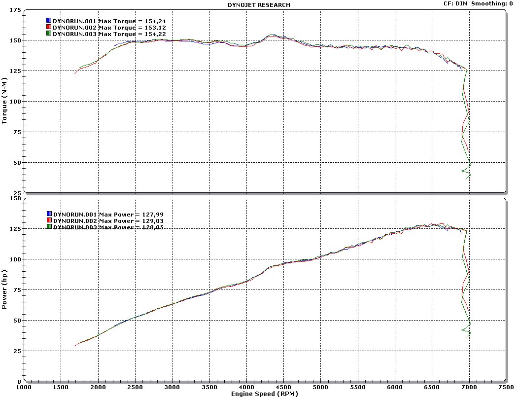

At the beginning of the question, is this graph looks properly:
[img name=]http://www.aeu86.org/files/_4/thumbs/t__4a_ge_dyno_916.jpg[/img]

neither of those dyno plots is a 4AGE... (they appear to be the same) The torque output exceeds most 4AGE engines capability.
This is what a stock 4AGE plants (@ the flywheel)
[Image: AEU86 AE86 - Stock 4A-GE specification]
Longevity... I know quite a few original 4AGE engines exceeding 200k miles

U are right it's actually a real problem. I have never seen two the same dynos.

MOST of the ECU's cut out @ 7500 rpm. As you can see from the dyno chart the engine makes peak power @ 6600. So... it doesn't ever break out of its safe operating zone since the camshafts limit power production before the ECU limits the rpm range.
