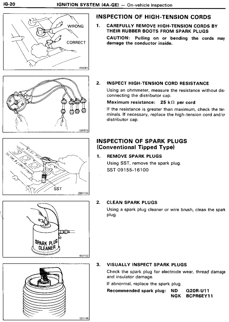

02-10-2005, 12:59 AM
Spark plug wires
I need a set of spark plug cables. My local dealer found 2 prices, 55 and 180 E. The 2 prices where for different types of engines(in years).
Can I use them both and wath makes the diff in price?I thought 180E is to much for me.
What are OEM cables, is this original toyota.
I just need a reliable set (no power gain).
02-10-2005, 01:10 AM
Spark plug wires
@Zax: Looking for this maybe? :wink:
