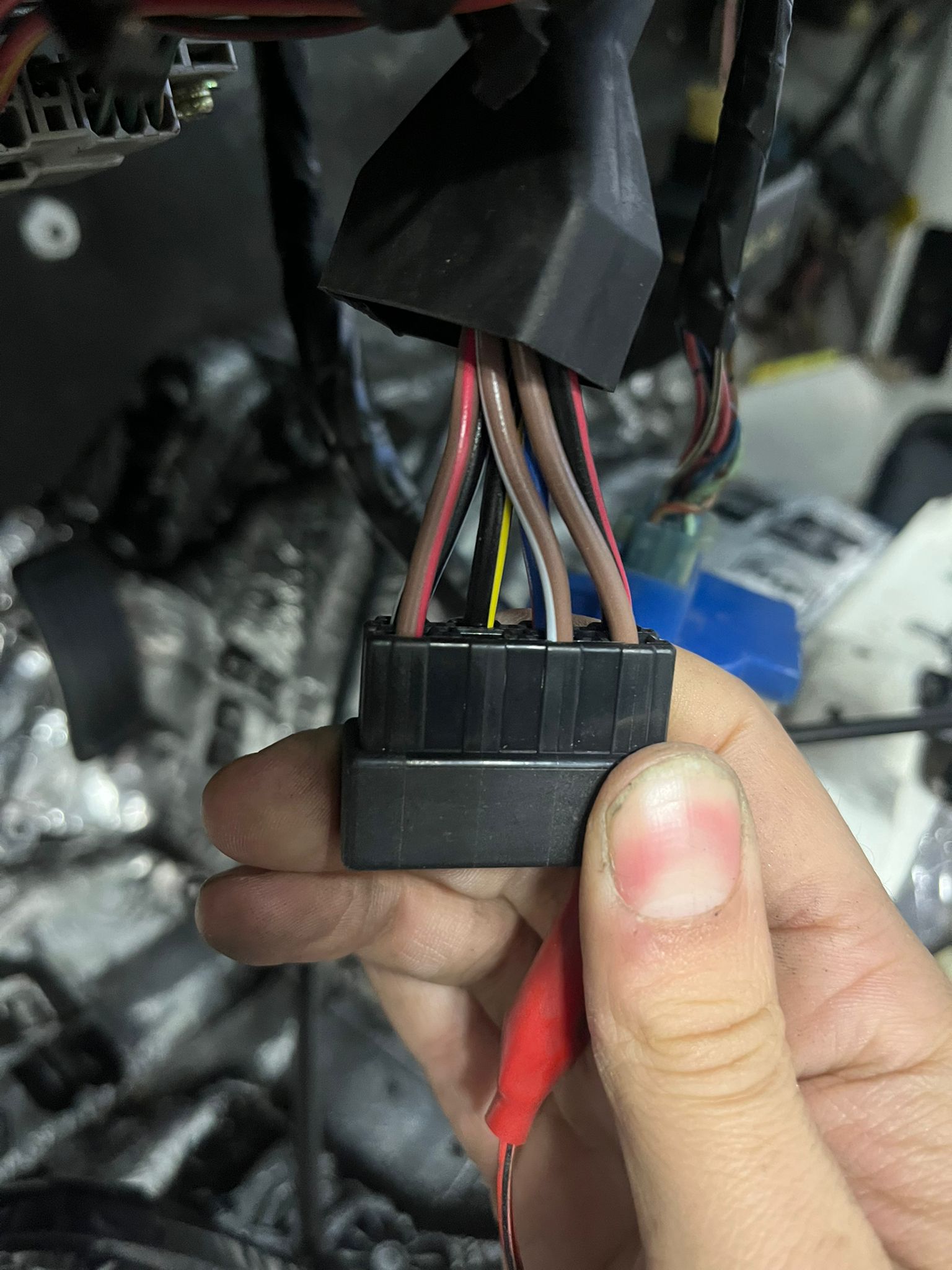

The problem is in the connector from the dashboard harness. The "top" row (AM1 - ACC - IG1 - ST1) everything is correct, +12v arrive from AM1 and when i turn the key the starting motor activate.
In the "low" row (AM2 - IG2 - ST2), on the harness side, i have only 2 wires, one white and the other black with orange stripe, while on the switch side i have 3 wires, one brown, one brown with white stripe and one brown with red stripe. This second row seems completely isolated from the top one, and do not receive voltage in any key position.
I've figured it out that the white wire i have, when voltage is applied, give power to the headlights motor, but i don't know what else, while the black orange, i have no idea, could it be related to ignition coil?
[Image: AEU86 AE86 - Ignition switch plug and wires]
I could maybe splice the AM1 cable into the AM2 one, to feed also the low row and have voltage on both the white and black orange wires but only with key in ACC or ON position.
Does it make any sense?

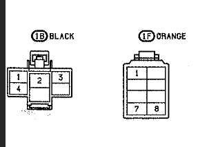

According to the wiring diagram it looks like the white wire should be the AM2 arriving directly from the battery positive, so i would expect to have a positive 12v on it, like on the black/red one.
Also, yes the black/orange looks like is for the ignition coil, which would also explain why i was having no spark.
Looks like i have to check the 1B Black and 1F Orange connector on the J/B in the driver side

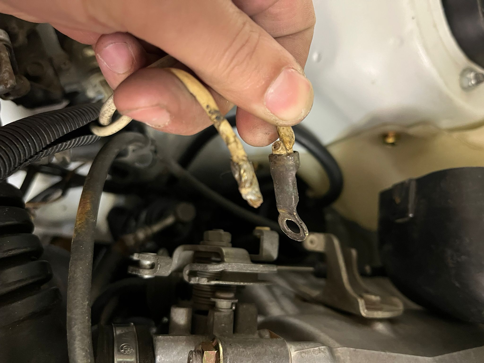

11-25-2024, 12:29 PM
Found the guilty Dodgy
That's why i wasn't getting 12v on the white cable.
Now i just need to test igniter and injector, and i should be ready to start it up very soon Smile
