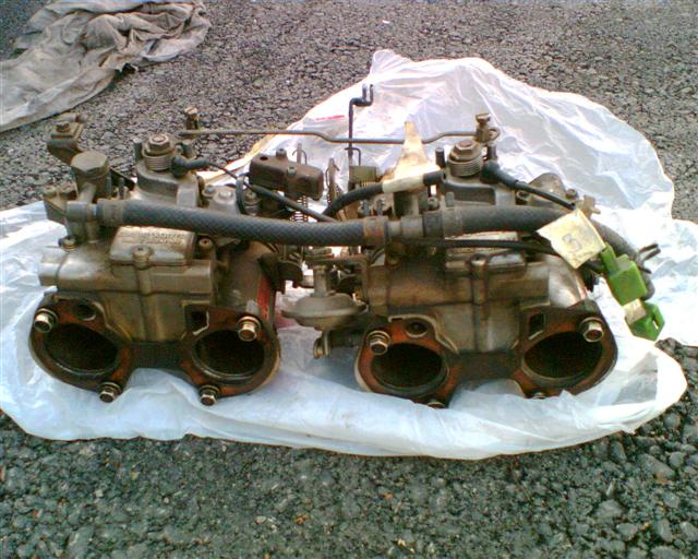

Hey I've got here something i'm interested in buying..would it be worth it and how much more do i need to make this setup work on my hi-comp redtop?
![]() I'm in the us,anyone know where I can get these refurbished or something at least make it worth while? |

faz Wrote:Hey I've got here something i'm interested in buying..would it be worth it and how much more do i need to make this setup work on my hi-comp redtop? Stock carbs of 2T-G engine (TE71)... IMHO it's not worth it... not much power (2T-G produces with them pretty lazy 115 KS), and hard as hell to setup them right. IMHO 4AGE stock EFI is much better then Mikuni-Solex solution. Weber 45mm would be different story, and if you can get your hands on them... :wink: Pics of carbs from my friends TE71 Toyota scrap yard car park = AE92GTi - AE82GT - KE30 - KP62 |

jamiemirror Wrote:meshin, 2TG is 8-valve engine, why do you compare it directly with 16-valve numbers ? I didn't compare it directly to 4AGE ... I just said what power produces on 2TG.jamiemirror Wrote:IMHO no way for stock 4AGE EFI to produce more torque (or power) than 40s sidedraughts except wrong carb. setup. I wasn't talking about any 40mm sidedrafts carbs... I was directly talking about this ones. With this Mikuni-Solex carbs I and my friend are playing now for a couple months and we both don't like them. On 4AGE it could make more peak power and tourqe then 4AGE EFI if it's setuped right (wich is hard as hell), but my opinion is that with EFI setup you would get much better usable power / tourqe bandwith... and it's a lot easier. Weber 40 or 45 would be much better solution and different story... and if you want 4AGE carbs that's the best way IMHO

meshin i dont think you are correct.. there is no chance that a properly setup mikunis 40 produce less torque/power than the stock motor.. As i've read they work just about as any 40mm carbs out there, when properly setup.. but hey its carbs.. they have to be.
And carbs are a lot cheaper solution than ITBs, where you need a standalone ecu, which is not cheap and sped even more money to properly set it up.. imo there is no cheaper torque/power for a 4age than carbs. |
