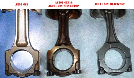

Blacktop bearings are different from every other 4age bearings. Look at the side conrod grove. "Normal" conrod bearings have a hole on the middle and BT bearings don't.
