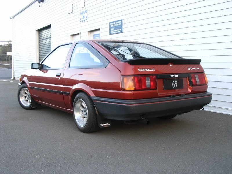

Since I am in the process of looking for better springs, I just
happen to have a whole bunch of measurements handy Smile
Front eyebrow height = 300 (centre of hub to wheel arch)
Rear eyebrow height = 290
Front body seam to ground = 130 (at jacking point)
Rear body seam to ground = 135
[img name=]http://www.aeu86.org/files/84/84ae86gts_554.jpg[/img]
Wheels are 13 x7 with negative 7 offset from memory. The springs
are Jamex (Asian I believe) which give an acceptable ride height, but
they are too soft for even moderately spirited driving.
Cheers... jondee86
