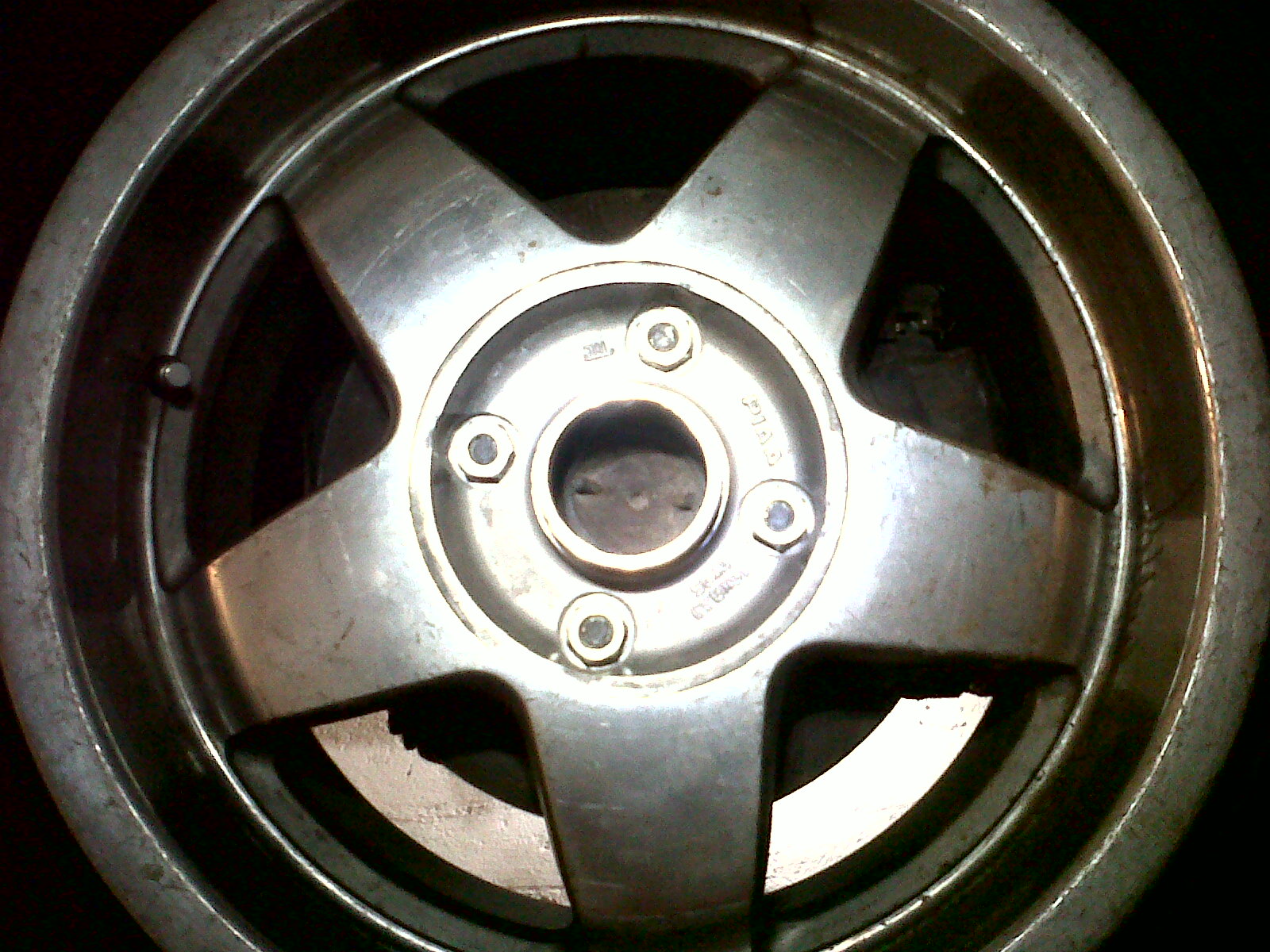

A small update.
The workshop started on getting the S13 front brakes on the 86 rear.
Discs put on and hoping to get the bracket done soon.
As I'm using 16" wheels the caliper should clear the wheels easily

S13 Front brake discs and calipers are now on the car..... Smile Smile
Its test drive time now Smile
