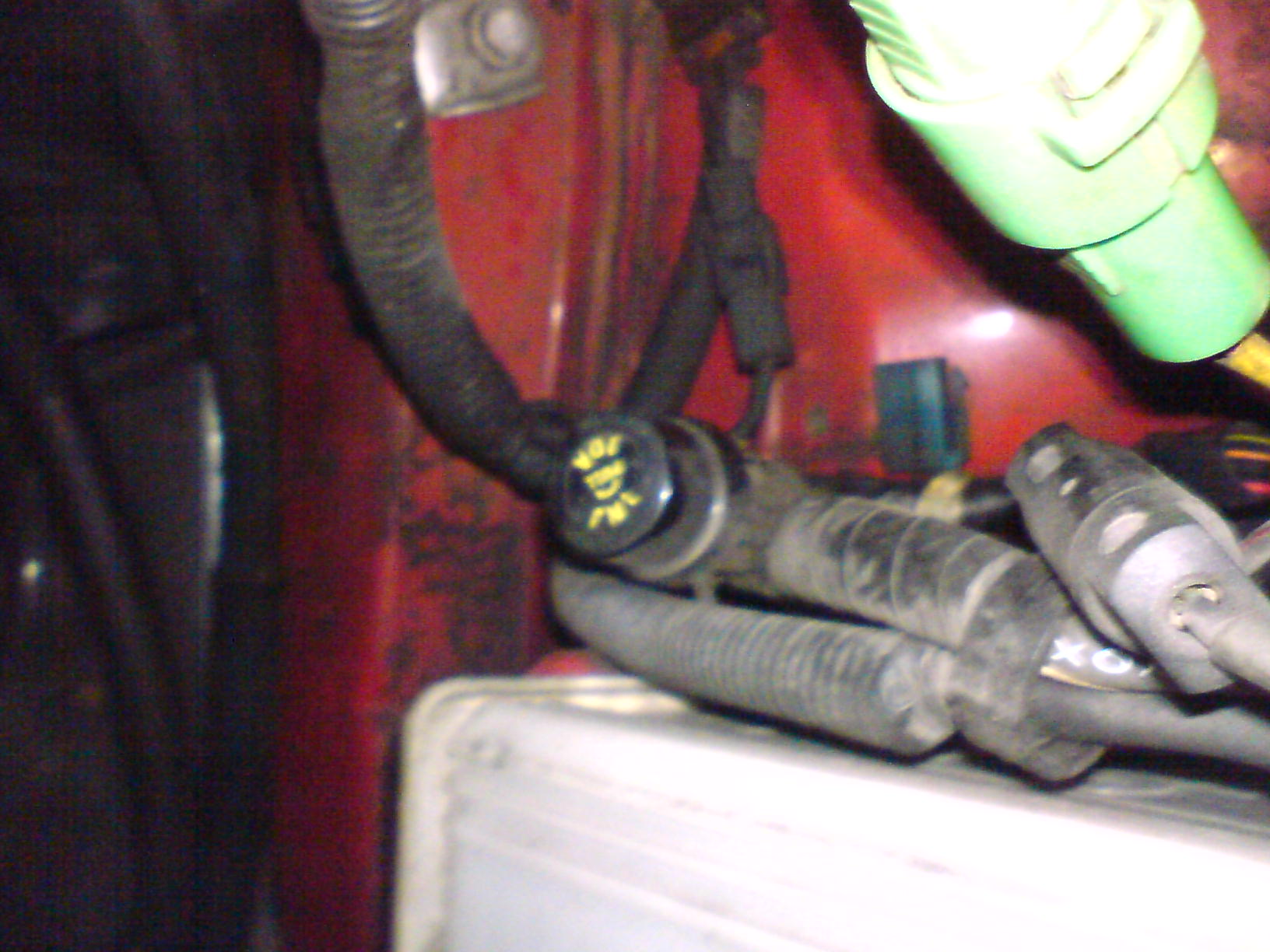

					alright I've did some pondering and testing:
Pic1: is normal operation Pic2: I pulled the 'EFI Main' - the engine check light doesn't illuminate Pic3: injector fuse thingy I couldn't see on your pics Pic4: overview on how it looks on mine now the 'Engine Main' in the fusebox does feck all - the engine starts also even with it unplugged... and as mentioned above when I unplug the EFI Main my engine check light doesn't illuminate either and the engine will crank (starter works) but not run, just like yours so you might want to check that. also you seem to have other stuff plugs sensors around that area I don't have comparing your pictures with mine so I'm not sure (see pic 3 and 4) Hope that helps and good luck - as mentioned before if you need anything else let me know I'm glad to help   - just not on the weekend that is still reserved for my wife as we are still new in this country and I don't wanna live her bored home alone yet ![]() PS: might wanna add me on MSN and/or Skype if you have that AE86 ex-daily  |
