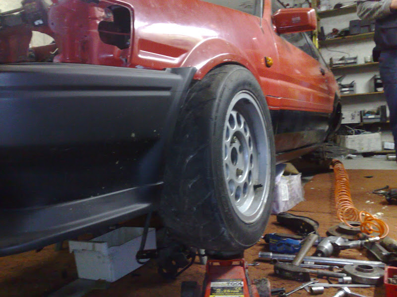

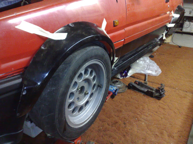

down off the spit for the first time in a year. ![]() Engine bay all prepped seemed and primed. ![]() Inside and tunnel seemed and primed. ![]() ![]() New fab’d cradle for the fuel cell. ![]() Rear axle, needs to be lower. ![]() ![]() Seriously wide on the front, alot wider than rear, may need overfenders on my overfenders. ![]()

Overfenders on overfenders!

This is how it looks on my car with s13 suspension
![]() ![]() CBY does the job nice. Drifting - best fun you can have in your car with your pants on! |
