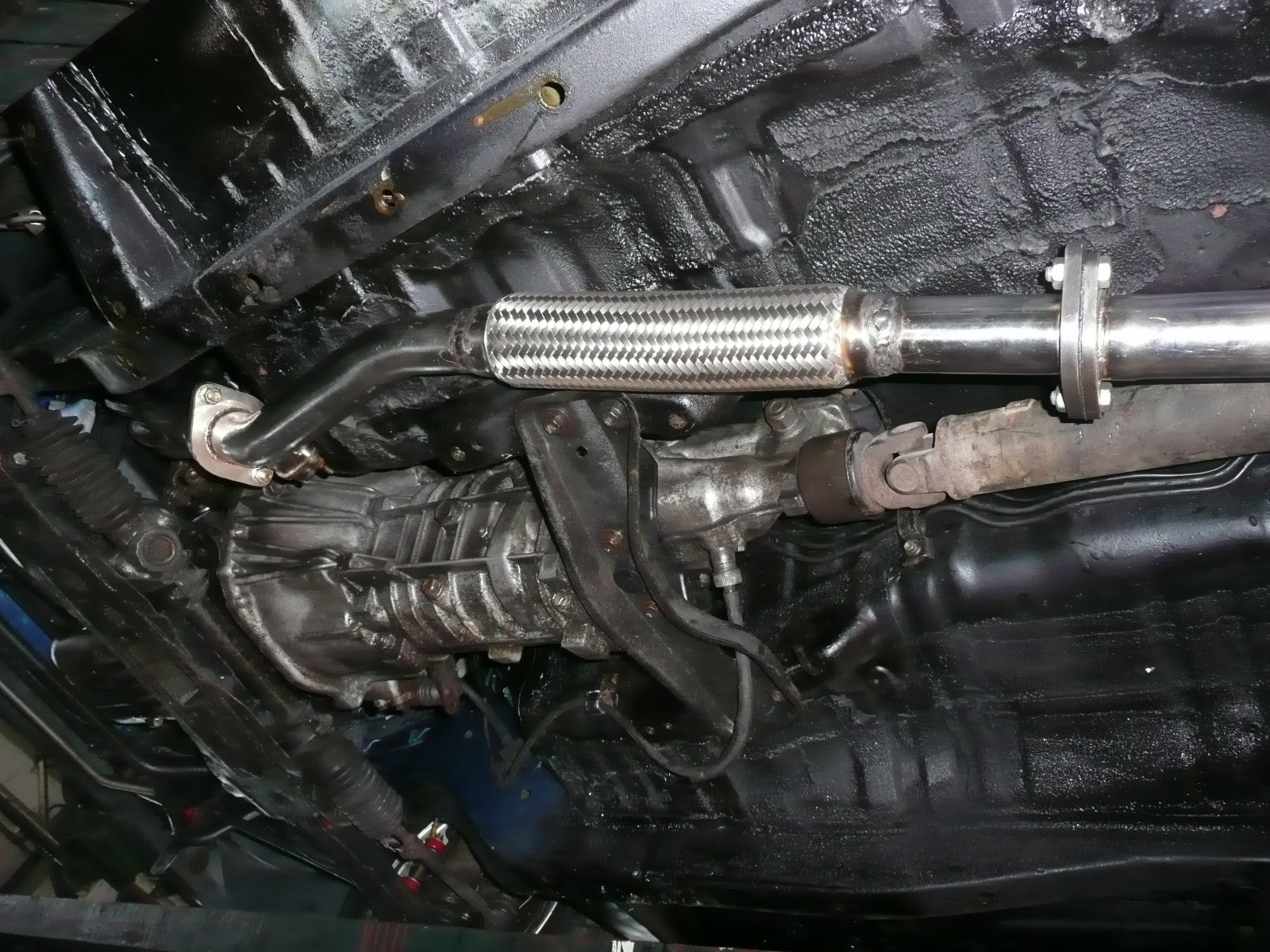

Now the full info
The OBX system was build for a exhaust with catalyst converter.
[Image: AEU86 AE86 - OBX Exhaust Systems]
The missing piece
The fill up
The result
Conclusion, the OBX system is a cheap way to replace original. Its loud and doesn't come with a silencer. The quality is decent. Thought I had to weld a small leak in the connector part of the header (wasn't welded shut)
If you are handy the OBX system is a good "upgrade" from original but don't think its direct swap.
12-13-2009, 09:55 PM
OBX Exhaust Systems
You forgot to mention that it nearly touches the chassis floor under your feet. This wouldnt be important to mention if you werent using cusco lower engine and gearbox mounts that bring the engine down a notch.
There's a good chance that it simply would foul the chassis otherwise.
Also you have shortened the rear silencer mount and it is still quite low to the ground (the bend before it goes up over the diff). And you had to weld a hole shut that was left open on the flange of the downpipe.
Just a warning so people dont go thinking it is a good fit, because it just isnt.
For the money it is not strange that you have to do some modding to fit it, as robo demonstrated it can be pulled off with some minor welding.
