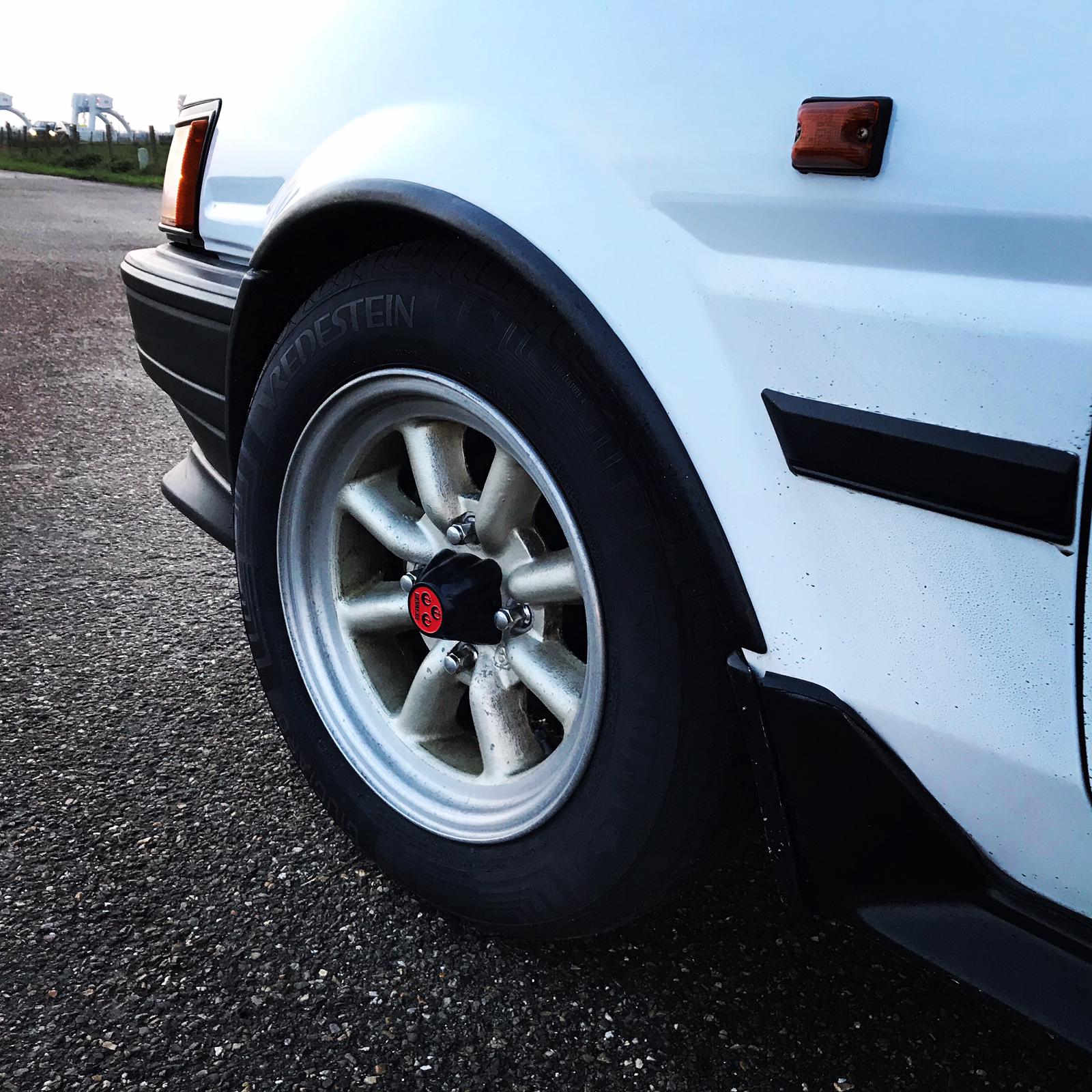

Yes, pistonrings were replaced as well to my knowledge. Thanks for the tip, i’ll look at it and will discuss it with the mad mechanics.
And I receieved some centercaps in the mail for the watanabe's....the finishing touch!

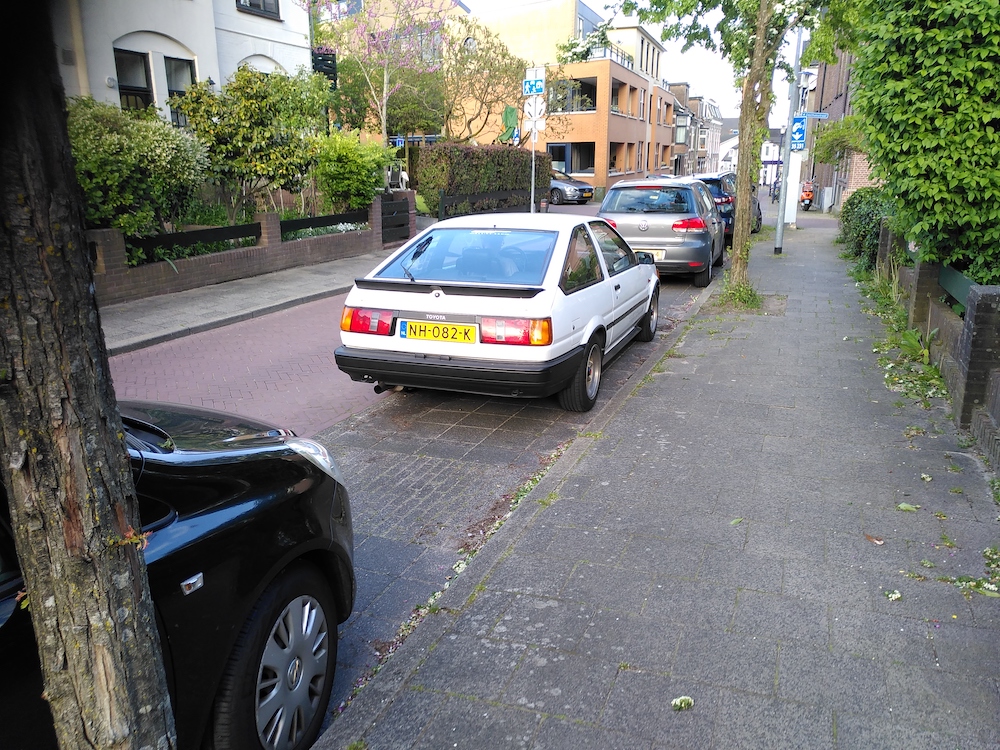

Today I was happy to see Robert's AE86 IRL:
[Image: AEU86 AE86 - NL: Robert]
A very good looking 3 door! Hurray!
